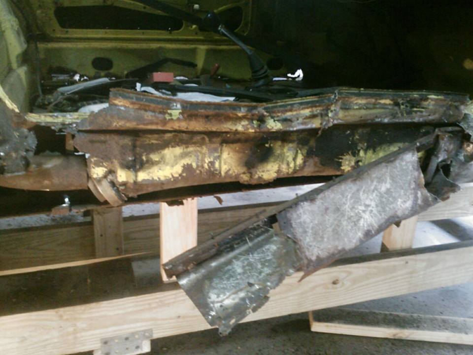

I lifted my car for the first time today. The longs have rust and the gap at the top of the door widened (the weight of the rear of the car was pulling it down such that the door gap opened more at the top (see pic below).
I'd say it was double what it is when the wheels are on the ground. So, I won't be surprised if this is because of the rust having weakened the chassis (in fact, I'm glad that it didn't snap off completely), but I'm wondering if some widening like this is normal when the car is lifted from the jack point areas (i.e., using a two post lift) and, if so, how much one should expect.

This is what my longs looked like. Had some sheetmetal and angle iron covered with fiberglass.

Vacca Rabite   :agree: That car has cancer. Probably bad if the ...   Aug 10 2014, 08:44 PM
scotty b   bad news. All that bubbling under the gold decal i...   Aug 10 2014, 09:03 PM
doug_b_928   Yes, the car has lots of cancer. Good to know tha...   Aug 10 2014, 09:18 PM

doug_b_928   Thanks for the feedback guys. I removed the engin...   Aug 11 2014, 05:54 AM

SirAndy   Post some pics of your passenger side longs. In yo...   Aug 11 2014, 08:35 PM
doug_b_928   I don't have pics on this computer, but if you...   Aug 11 2014, 10:07 PM
Claus Graf   Had I done the test of opening the doors and jumpi...   Dec 11 2014, 08:40 AM

doug_b_928   I built a bench a la Hail and put the car on it. ...   Dec 12 2014, 10:13 AM
