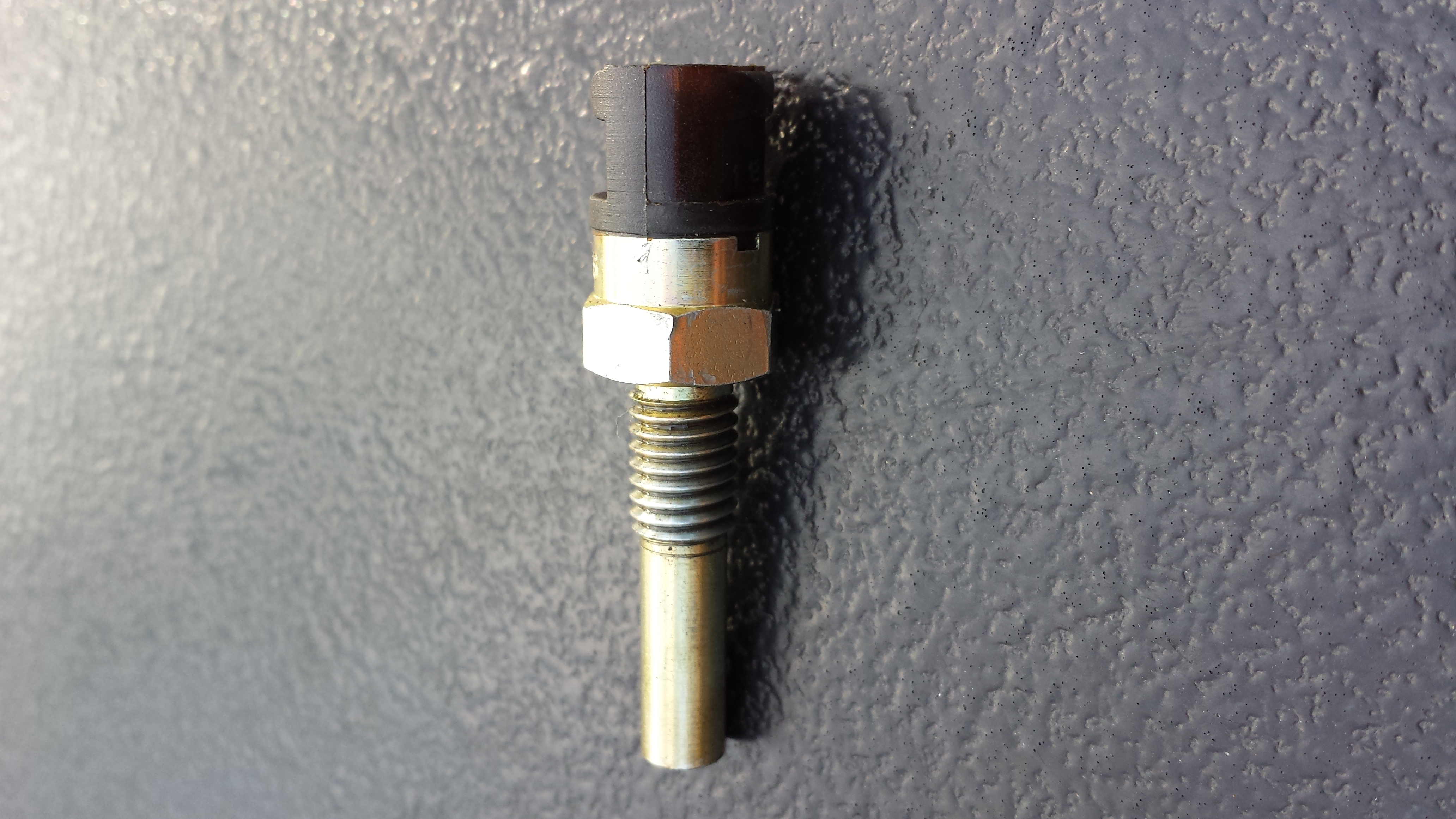

OK. car has been in shop for the past week, and today Bob spent several hours on it but what he found was when the MPS is disconnected from the vac hose it will idle and run, but when it gets connected it goes immediately lean and dies, and will not run with that hose on there- the MPS holds Vac no loss of pressure, but that doesnt mean that its not bad.
1- i thought that if an MPS went bad it defaulted rich? but when this is getting vac it goes lean right away and dies. but it will run and idle with out the vac , the AF meter then shows 9.8-10.2 or so which is of course rich but not flooding out.
so the question is why is it going lean when hooked up? when this issue started about 2 weeks ago, it had been running just fine and all of a sudden it quit running.
2. could there be another issue we dont see that would be making it way to lean other than the MPS?
might need to test another MPS, my 2nd one i just bought from someone here and it has never been opened but will not hold vac (slowly looses vac pressure) so it probably need to be opened and re-sealed. not a good candidate to trouble shoot with. ------
FYI- 1975 d-jet 2.0. newer wiring harness , CHT is newish(replaced 2 months before this issue started and was running perfect at that time)

Is it possible for this one part, the temp sensor to cause the issues if ev described?
