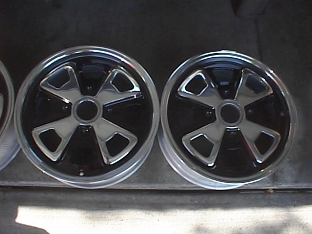

But anyway.. here are the damn Fuch's I can't use.. cause of the damn 5-lug conversion.. even though i really really want to use it cause i spent a load of $ to fix them. Damn wasted money!
