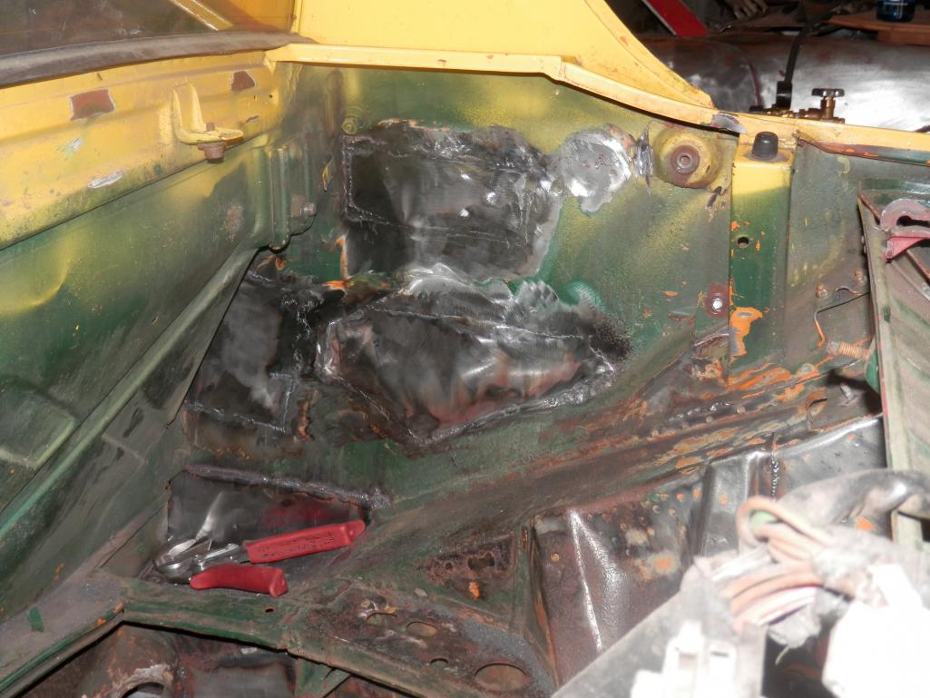

jd74914   Off came the fender for easy cutting into the long...   Dec 26 2013, 12:04 AM
jd74914   Once the cutting started, I had a really hard time...   Dec 26 2013, 12:15 AM
jd74914   A few more pictures of the suspension console and ...   Dec 26 2013, 12:38 AM
