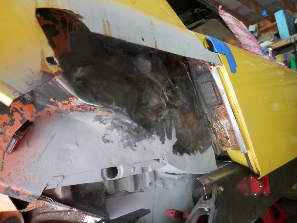

I was going through my camera and found some pictures of the next steps of this project (only a year after the last post haha).
In the past year I've jet-set all over the place for work, lost my job due to company bankruptcy, signed up for full time doctoral research in laser diagnostics, started an engineering consulting gig, had the opportunity to play with LeMans-grade engine control hardware (see Life Racing F88) and way too much more so my 914 progress has been super slooooooooooooooooooow. (IMG:style_emoticons/default/blink.gif) (IMG:style_emoticons/default/smile.gif) Hopefully life will let me get a little more done this year! (IMG:style_emoticons/default/laugh.gif)
The first pictures show fixes to the general inner fender structure where the metal was either soft or had been poorly replaced the first time around.
