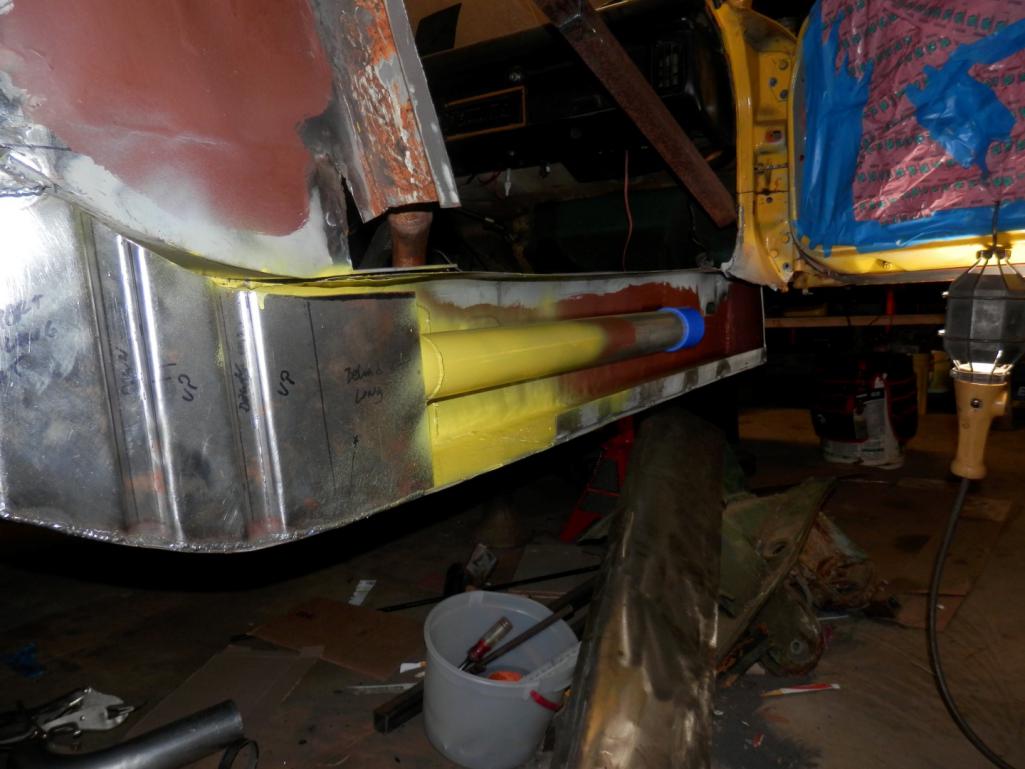

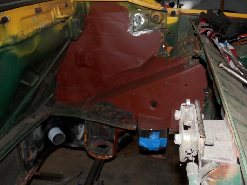

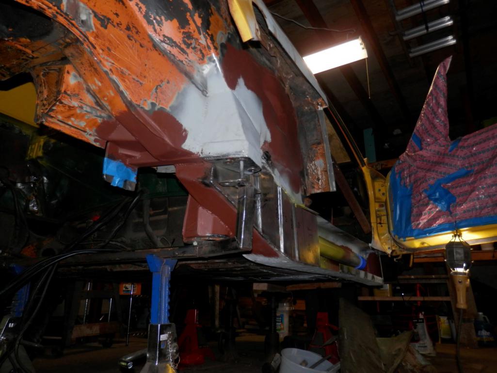

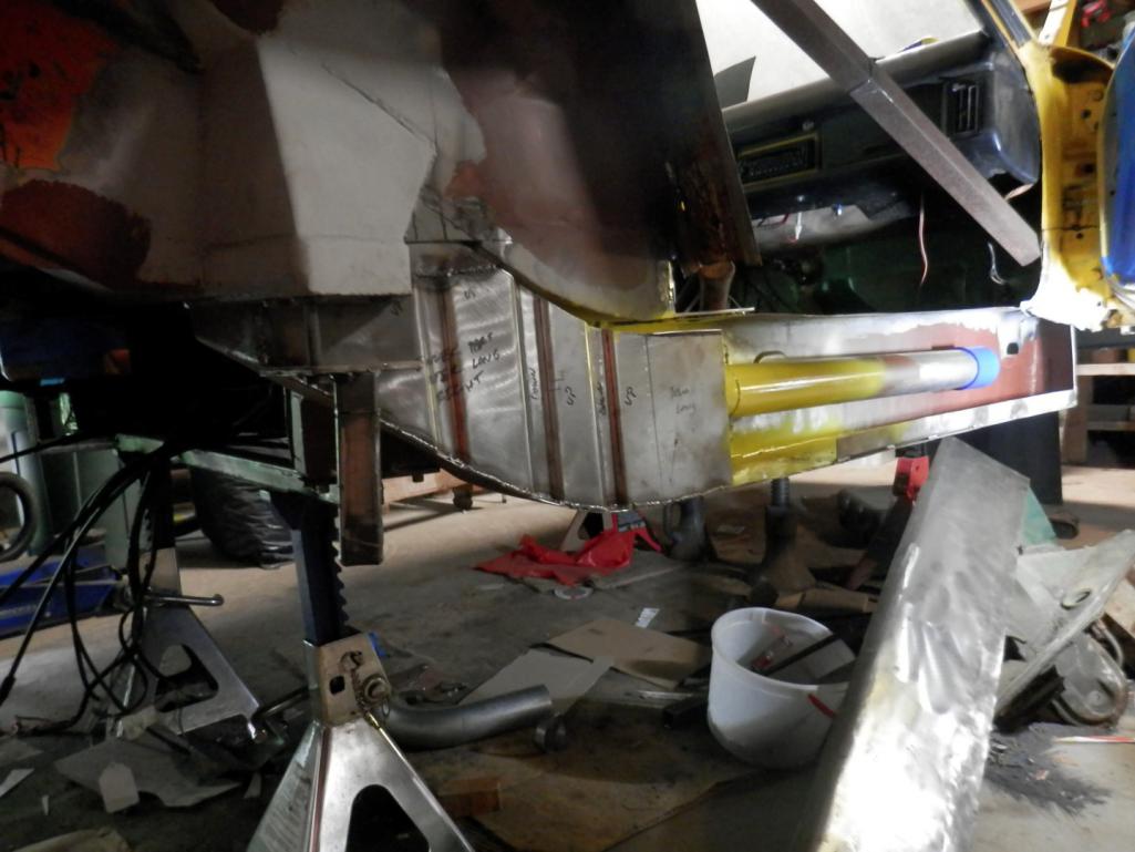

The trailing arm mounts were moved up by about 1.8 inches and completely remade. When I took out the old outer mounts 4/6 bolts snapped so remaking them was altogether easier than drilling out the bolts and retapping. At the same time I remade the longitudinal structure.

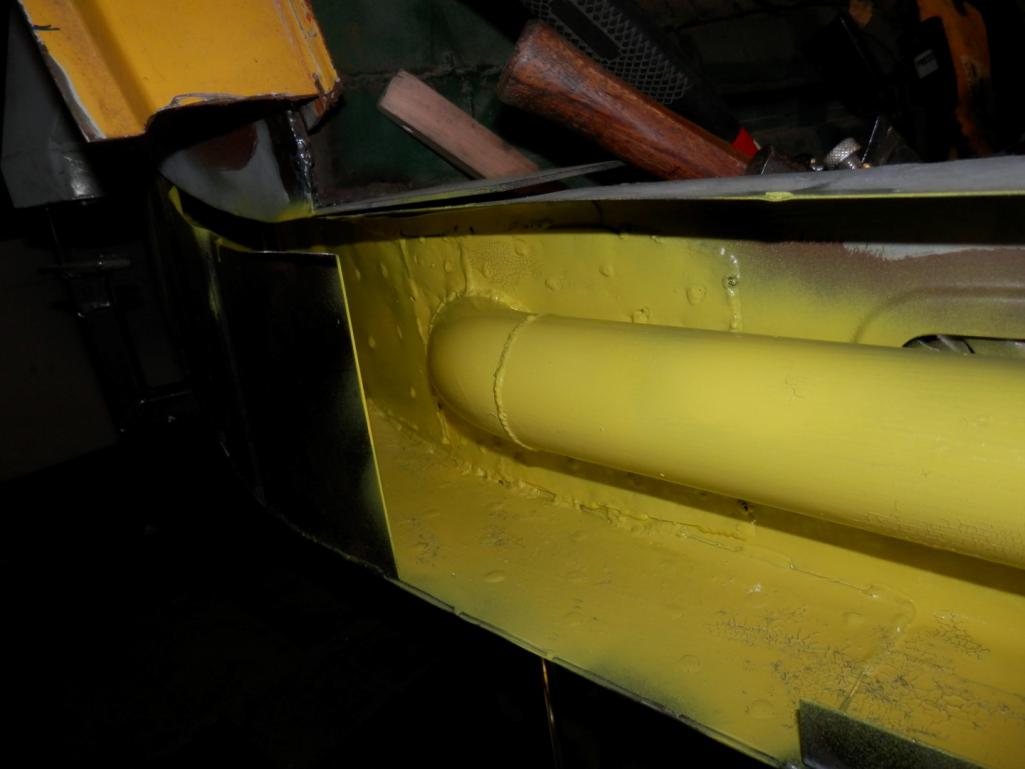

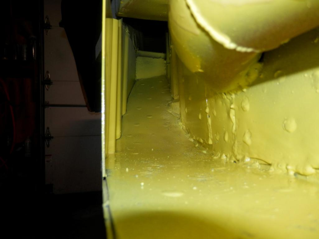

The longs themselves were redesigned and made taller with slightly different metal thicknesses/layering. This was done to increase the vertical moment of inertial and improve the car's bending stiffness in this area. From a design perspective, the new geometry (more or less 0.5" taller with some strategically sized metal thicknesses) results in a 246% bending stiffness improvement over stock with a stiffness/weight efficiency (in terms of moment of inertia/cross-sectional area) of 4.927e3 mm^4/mm^2 vs the stock efficiency of 4.042e3 mm^4/mm^2. Overall weight increase is about 27 pounds. For reference the Engman kit (best as I can tell since I haven't held one) weights 18 pounds and increases stiffness by 168% assuming an OEM long to start with.
You'll note that it will still be double layered with the corrugated inner. The insulated heater tube was removed and a solid tube put in its place. This might get used as a wire tray later. Anywhere there are butted seams there is also a backer lap joint.
