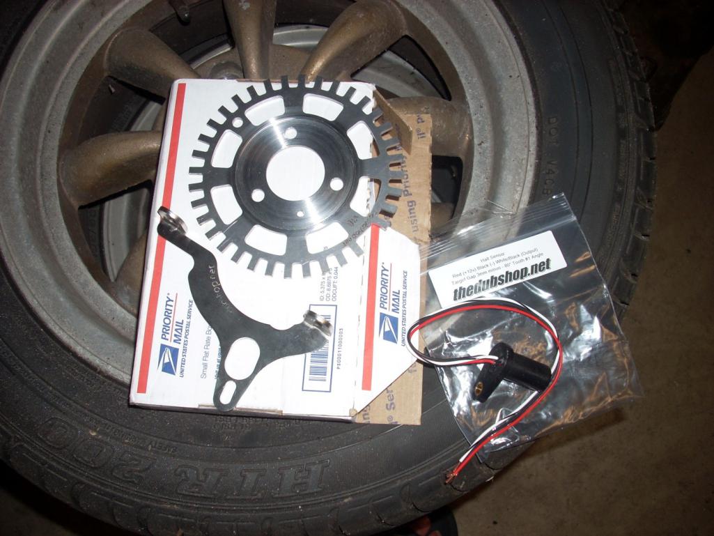

And just for fun some new stuff...
The trigger wheel is from Mario at The Dub Shop and I do need some tender springs. (IMG:style_emoticons/default/smile.gif)

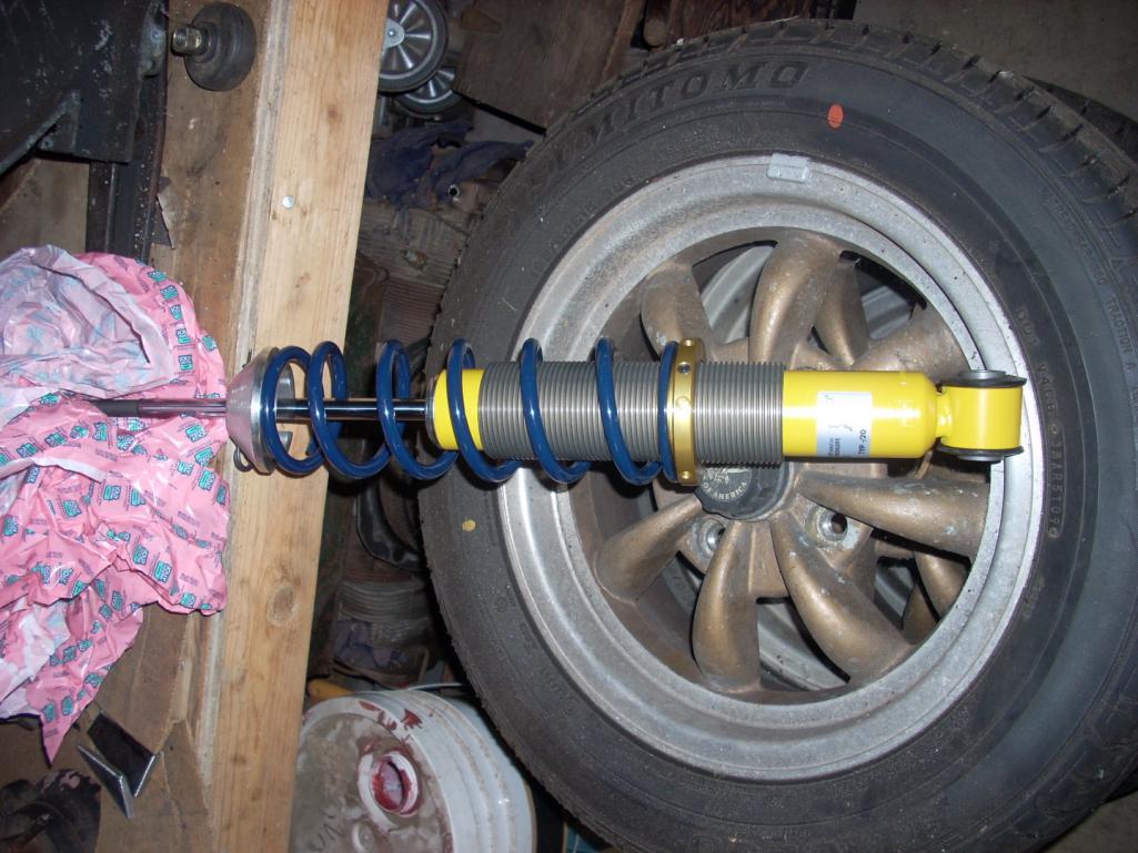

jd74914   Over the course of last winter, I couldn't sto...   Dec 29 2014, 03:43 PM
jd74914   The trailing arm mounts were moved up by about 1.8...   Dec 29 2014, 03:59 PM
jd74914   And just for fun some new stuff... The trigger wh...   Dec 29 2014, 04:08 PM

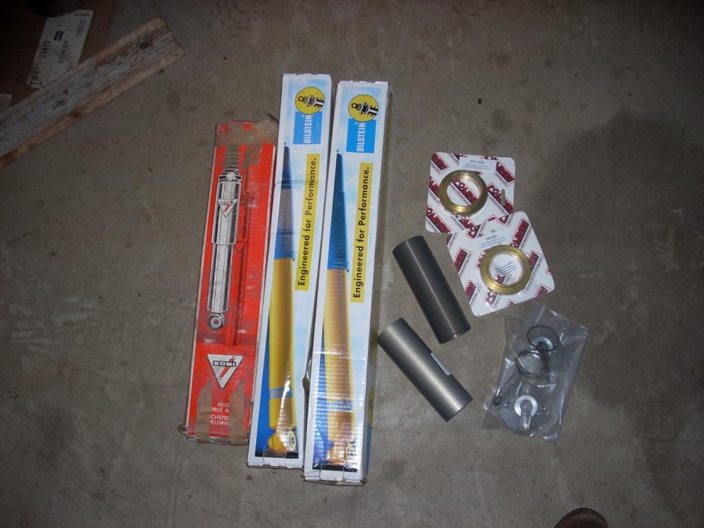

jd74914   Then chuckc here had a great deal on some phonedia...   Dec 29 2014, 04:14 PM
