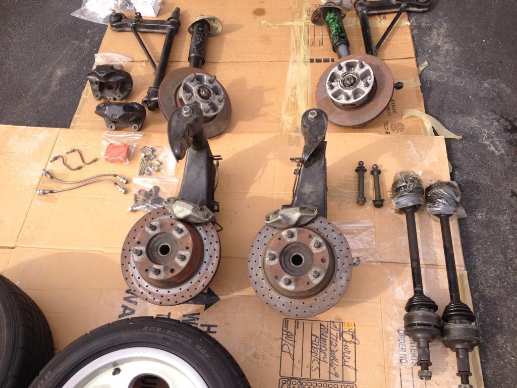

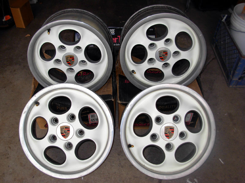

Then chuckc here had a great deal on some phonedials and the suspension to go with them so I just had to go 5-lug. Now the next trick will be raising the spindles on the Bilstein struts and selling the 4-lug raised spindle struts.

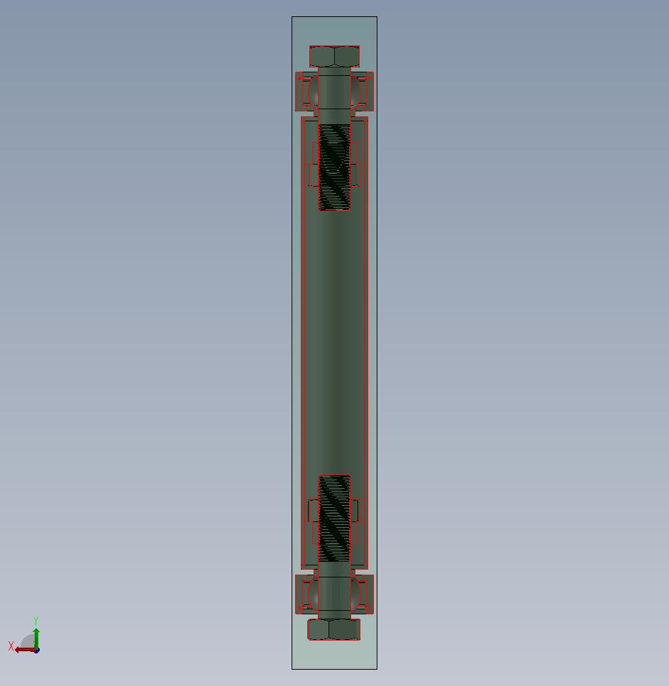

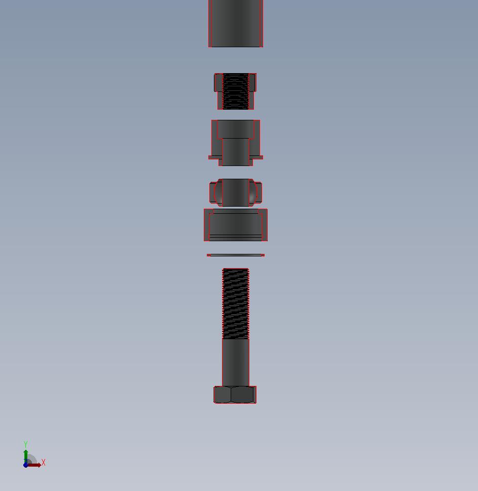

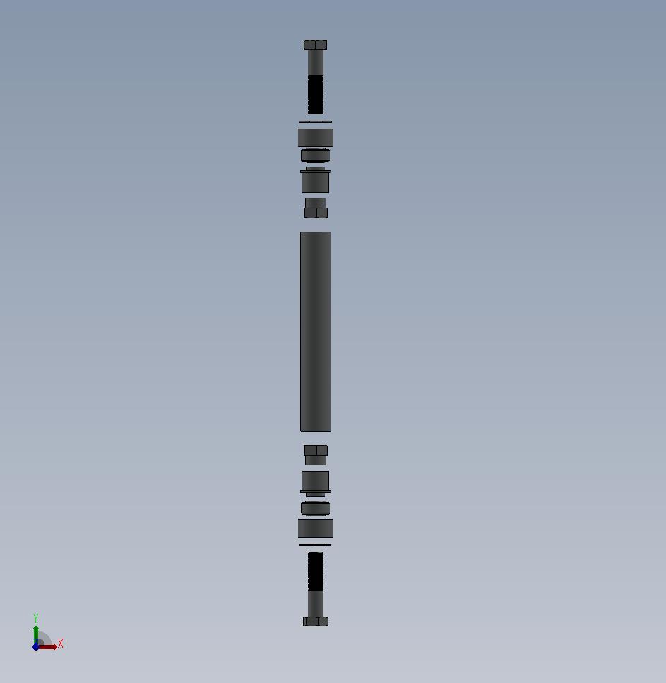

Quick exploded view of the new trailing arm inner features so they might make more sense (couldn't find the models yesterday night).

Chris Pincetich   Curious about that trailing arm inner and your str...   Dec 30 2014, 03:35 PM
jd74914   Curious about that trailing arm inner and your st...   Dec 31 2014, 11:36 AM
FourBlades   Awesome job rebuilding the long! :first: Le...   Dec 31 2014, 11:45 AM
Mueller   Great progress..... Have you considered using mis...   Dec 31 2014, 01:39 PM
yeahmag   Andy and I talked about this a bit. The problem is...   Dec 31 2014, 03:25 PM
Jeff Hail   The inner ear will bend/deflect a little bit when ...   Dec 31 2014, 06:58 PM
jeff   This setup should eliminate the bind when adjustin...   Dec 31 2014, 10:52 PM
