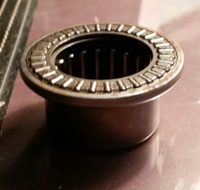

Have you considered using misalignment washers on the bolts?
Misalignment washers
If you want to play with and experiment with a needle bearing for cheap, pay shipping and I'll send you an old unused Nadella bearing that was left over from when I used to make the kits.
