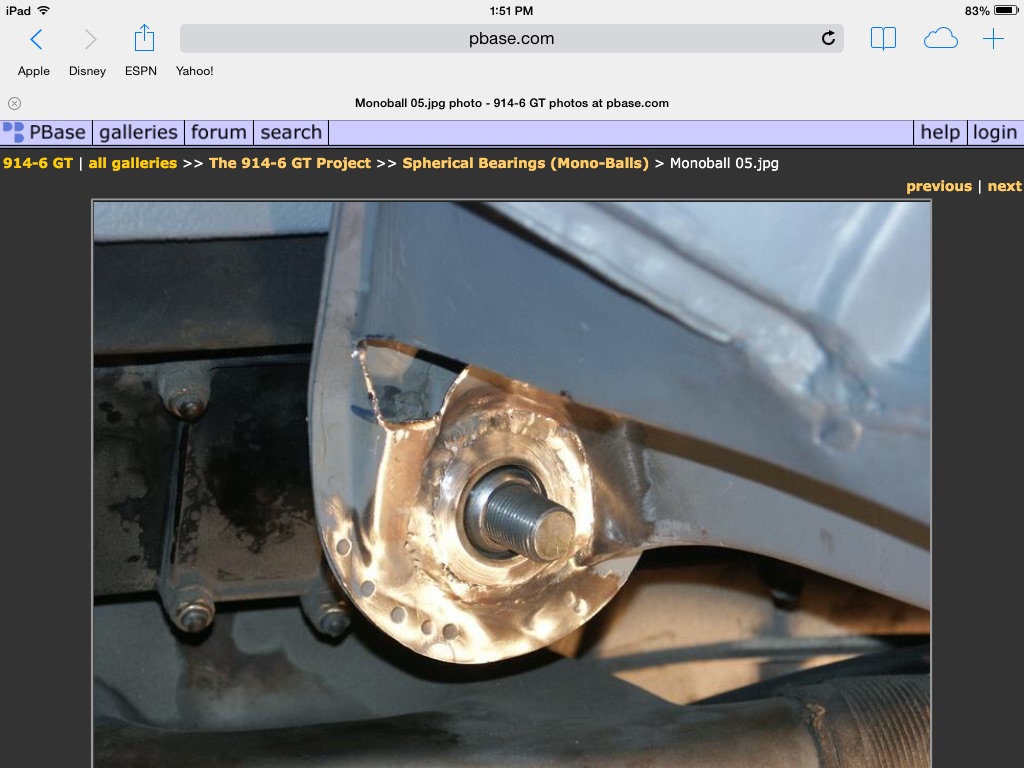

914forme   Collar on the outside it is a functional piece not...   Dec 29 2016, 06:33 PM
jd74914   BTW, Mine using a standard spherical bearing and ...   Dec 29 2016, 07:19 PM
914forme   Jim 3/8" due to me having a huge number of 3...   Dec 30 2016, 07:44 AM
jd74914   3/8" due to me having a huge number of 3/8...   Jan 4 2017, 04:38 PM
