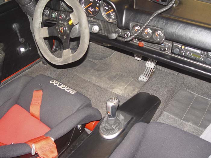

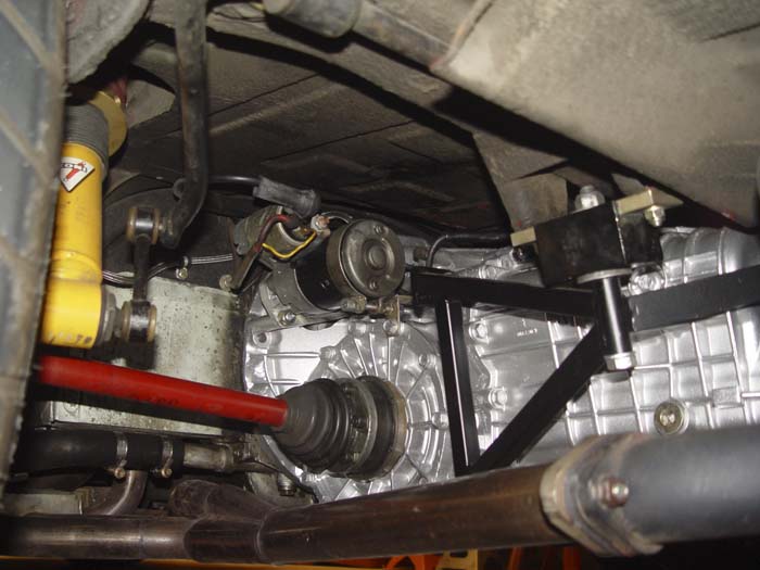

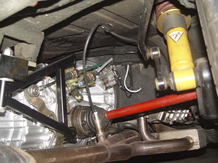

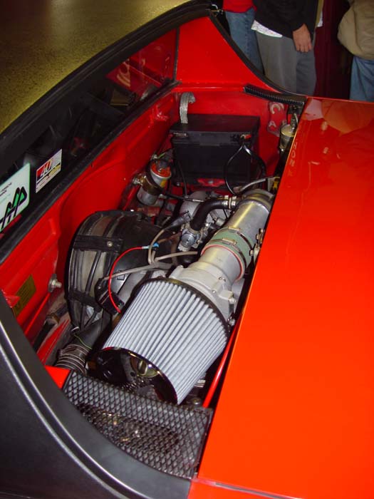

Probably easier if I just show his pictures...

bulitt   The pics above are from member "221kw914...   May 15 2014, 02:56 PM
