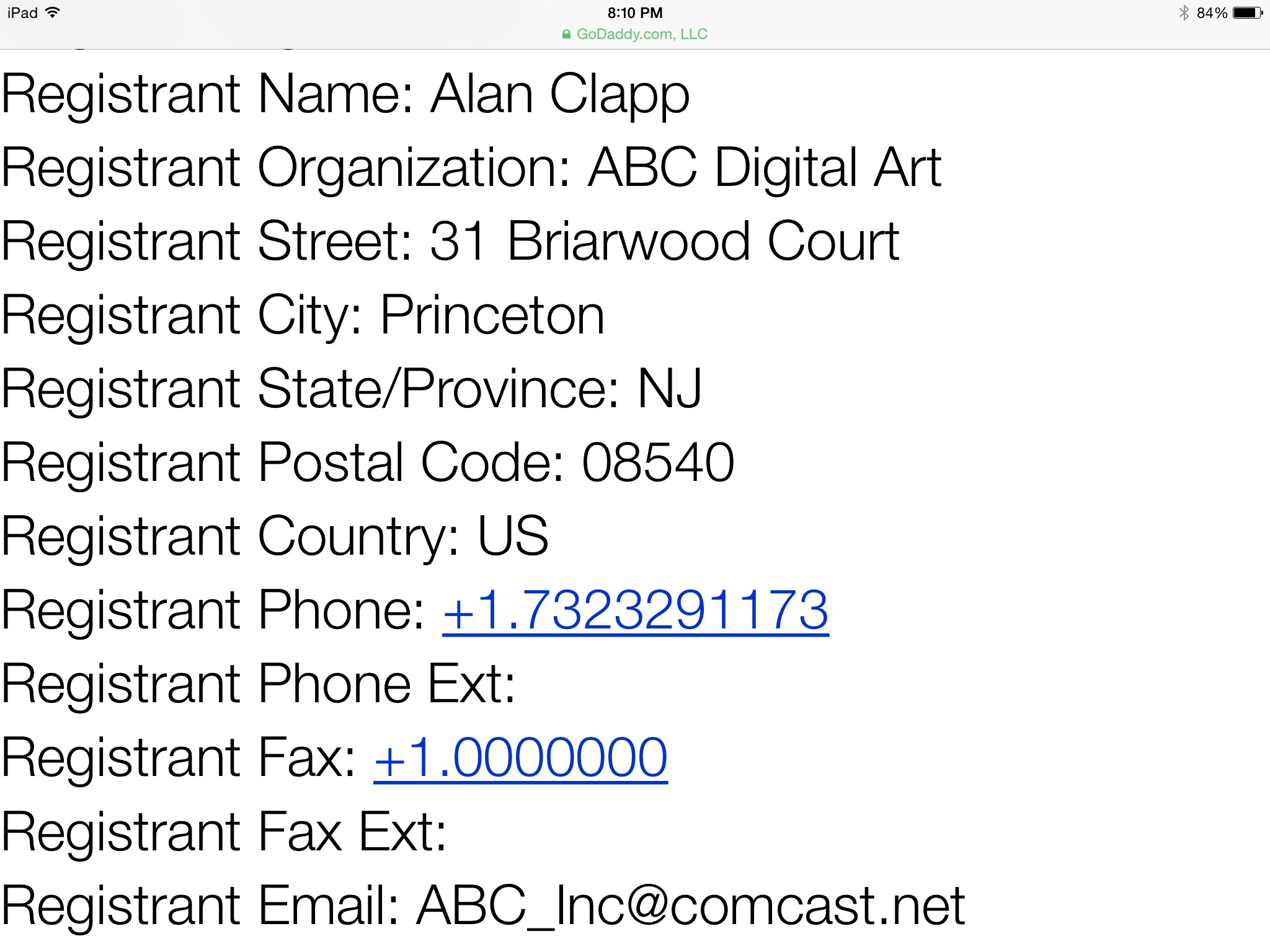

r_towle
post Jan 2 2015, 07:11 PM
Custom Member
Posts: 24,705
Joined: 9-January 03
From: Taxachusetts
Member No.: 124
Here
Whois database.
