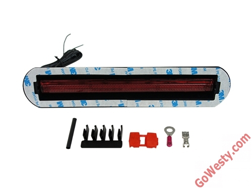

This is an economical ($25-30 part), easy & fast (1-2 hrs to stick-on & wire into tail brakelights/harness) for a quick 3rd Brake Light addition. This light unit is enclosed with wires & adhesive face to mount it to your rear window - no screws nor clips needed to mount the light & no reflecting glare off the glass.
You'll need to look at your 914 wiring diagram to see where best to wire it, but they can be dropped down behind the rear backpad & into the trunk &/or engine bay to tie into the brake lights & pull off any easy existing screw to body for ground.
This part is probably also available elsewhere - maybe cheaper - & is on sale in Jan 2015 at GoWesty (they put them on sale a couple of times a year as Monthly Specials).
There are also several other more expensive & complicated solutions discussed below & with links by other posters, if this doesn't suit your liking. .....
This should also work well for those who want to add a 3rd brake light to their 914 at reasonable cost, but you may need some extra wire to reach the taillight buckets/harness to tie into.

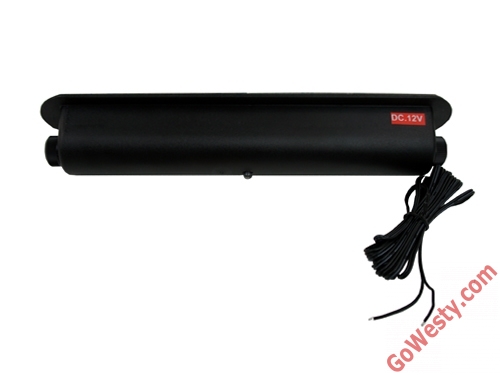

This is the GoWesty sold unit by itself for size comparison to the others on here:
I just measured mine on the Westy, & the overall unit is 9" W x 2" H - which includes a 3/8" flat flange all around for the sticky strip to adhere to the glass, & the back housing is 8-3/8" L x 1-1/4" H & 1-1/4" D - with a standard 1/2" H x 8" L LED strip that swivels within the housing to keep it level to face out properly (so no need to invert it for the 914's back-sloping rear glass).
I think that you can tuck the upper mounting flange up between the 914's interior upper rollbar pad & the glass, & simply trim off the lower flange if it intrudes into the vision area too much. Anyway, that's my thoughts.
