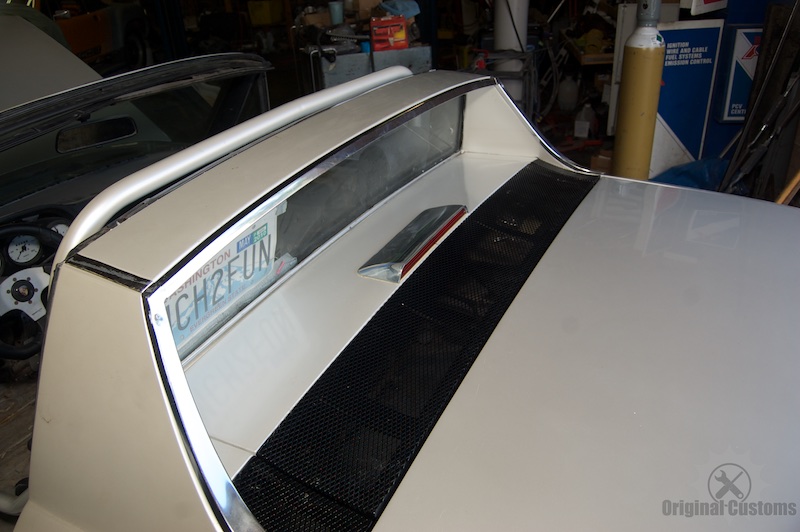

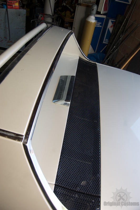

IMHO, it's better to mount the third brake light low (on the engine lid) because the upper part of the roll/targa bar seems like a good idea until you realize how much it can block your rear view mirror.
The corvette unit can be polished as well. (IMG:style_emoticons/default/drooley.gif) We did it on a customer car.
