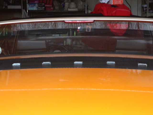

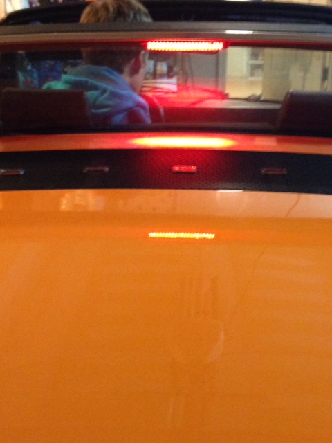

Just this weekend I did a 3rd brake light on my own 914 using one of these,
http://www.amazon.com/Custom-Dynamics-Knig...ag=theampfor-20
I mounted it facing down, underside of rollbar chrome. (will post photo later).
I have to say that it is a definite attention grabber and it looks factory installed. I used the mounting tape and did not cut or tap any wires as I picked up some piggyback quick connects at Radio Shack and simply used the existing brake light spades. Ran the wire underneath the chrome strip and through trunk. Needed a bit of extra wire but since these are LED, you can use 18-20 gauge. Again, you would really have to look for anything that looks not original. Took me a total of maybe 30 minutes.

I did not enable the running lights (just snip and insulate blue wire). The flashing stop light feature definitely commands attention. I put a piece of black electric tape along the window side so that it does not light up the cabin. If I were starting over I would probably just use some flat black model paint on that side. Given that the 914 sits so low, I like the fact that the light is mounted up higher where SUV's and minivans are more likey to notice.
