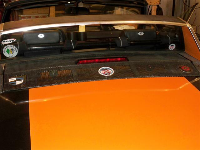

McMark   IMHO, it's better to mount the third brake lig...   Jan 4 2015, 05:22 PM
balljoint   Very nice. And it hardly blocks the view as much a...   Jan 4 2015, 08:05 PM
Mark Henry   Very nice. And it hardly blocks the view as much ...   Jan 4 2015, 08:08 PM
Mark Henry   Very nice. And it hardly blocks the view as much ...   Jan 4 2015, 08:12 PM
