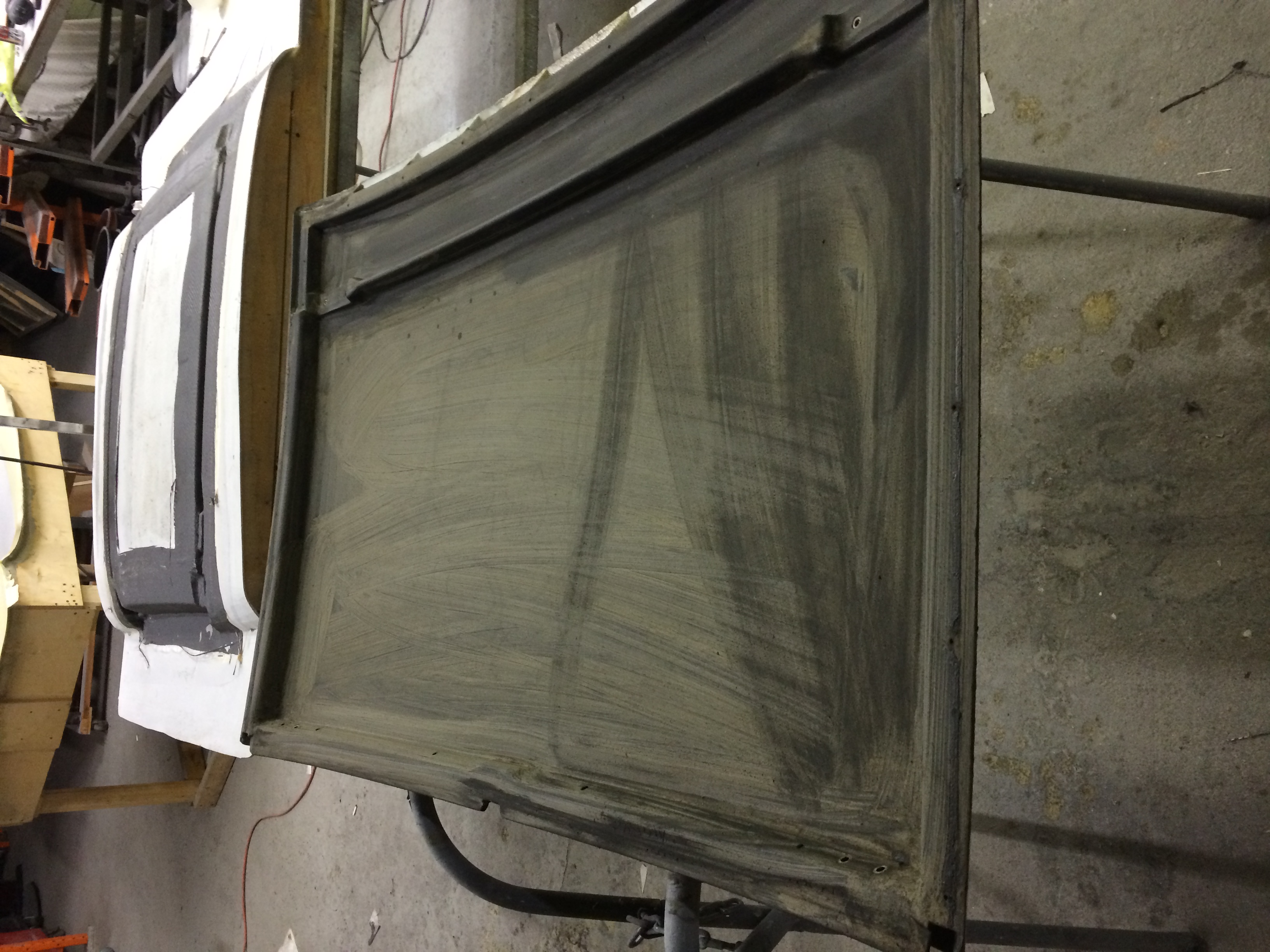

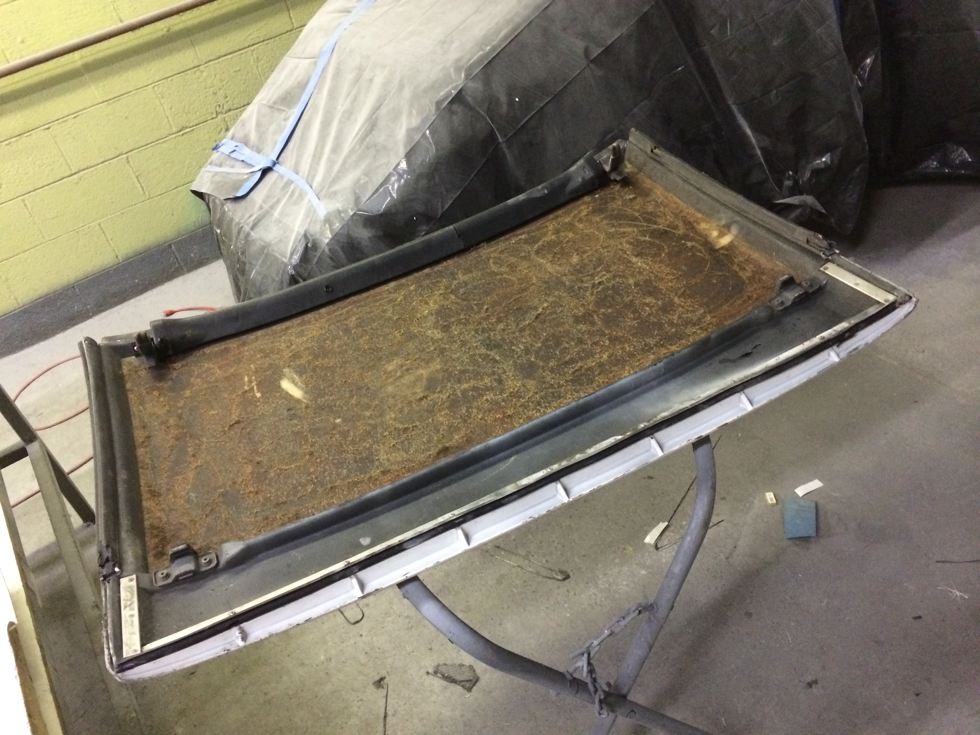

Just picked up the model top. Thanks Tim, Thanks Mike.
Couple of pics, as received, then with hardware and seals removed with paint stripping started.
Looking to get it bare and then determine the best course of molding.
Regards,
Todd
