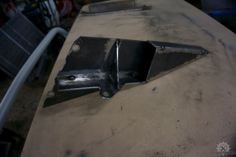

Once I had the general location I started making paper templates of the mount. It's a bit like putting together a puzzle, but instead of finding where pieces go, you just make your own as you go along. This will be made out of 1/8" plate most likely. The three circles you see will be bolts. The mount will be two pieces -- one underneath the tin and one on top. The tin will be sandwiched in between the two.

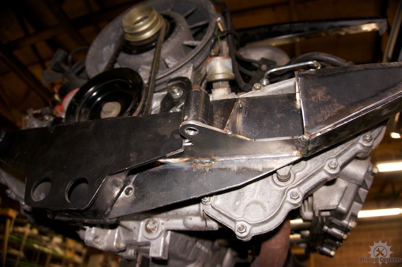

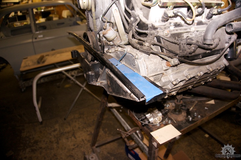

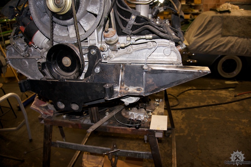

Got the steel version done. It's very rigid and will work great. Just have to final weld the whole thing and make a few more sub-brackets. (IMG:style_emoticons/default/beerchug.gif)
