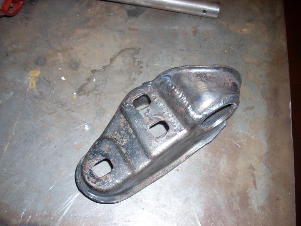

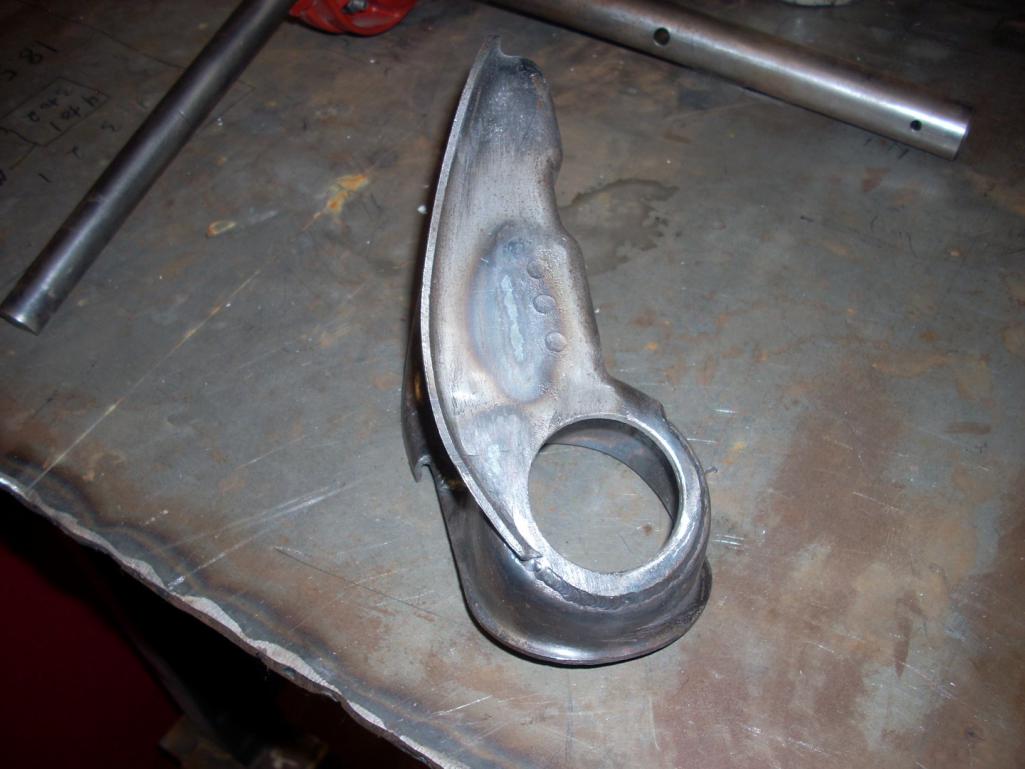

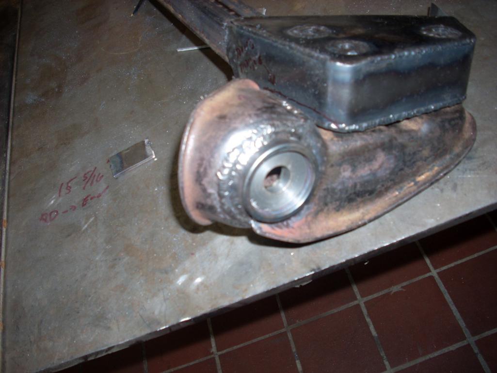

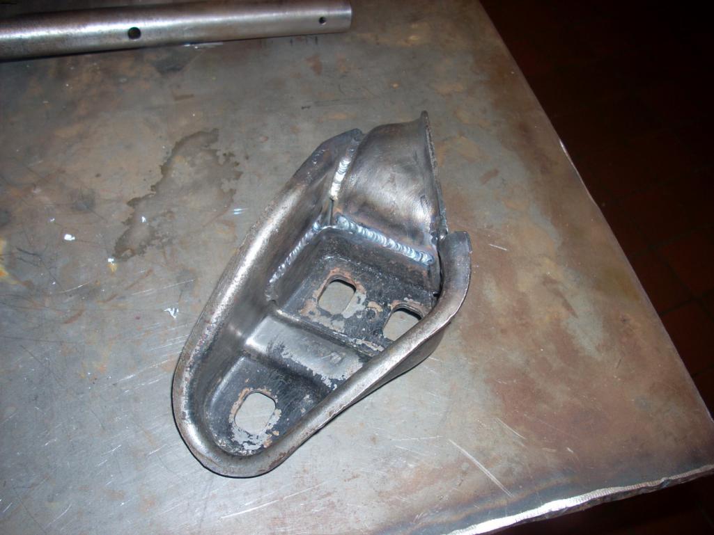

A few more pieces. I seam welded the trailing arm mounts and then machined 1.75" holes in them for my spherical bearing housings. I screwed up on the first one by not machining an insert to help it hold shape with all of the heat and warped it a bit which required a little honing. After making that mistake I turned an aluminum piece to pull heat out of the housing which seemed to work well. We'll see how the slightly out-of-round housing works out. The bearing pressed in OK, but I think I might make another one since we don't have a shortage of suspension mounts. (IMG:style_emoticons/default/laugh.gif)

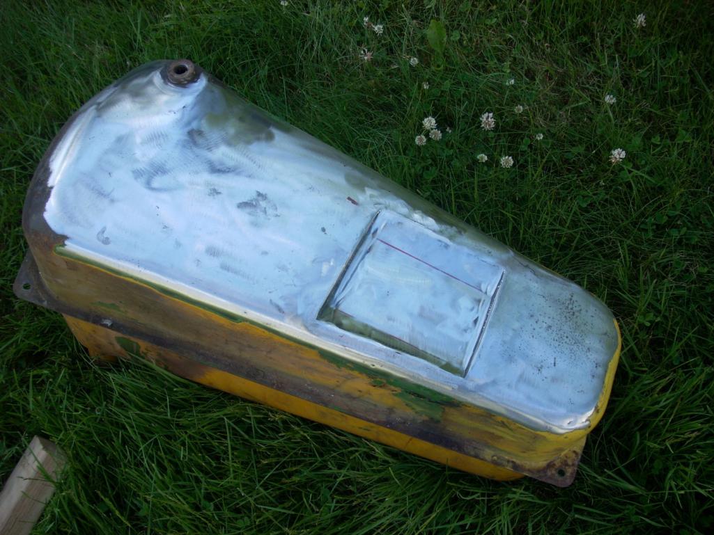

Unfortunately the final product picture is blurry, but I think you can get the idea. I just found the last picture and thought it was cool so I added it. It's of the bottom of the gas tank in a '58 John Deere 420C bulldozer which I clearanced to fit a taller battery for Father's Day.
