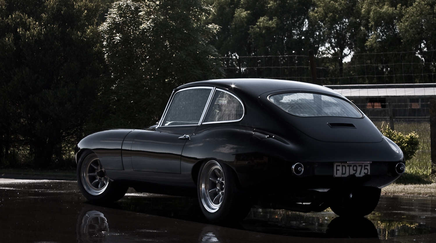

Like what you did with the 2+2.Immaculate in black.
Those t-lites look malevolent.I took a pass on an early roadster here in TO as the floors were a lattice of holes.
