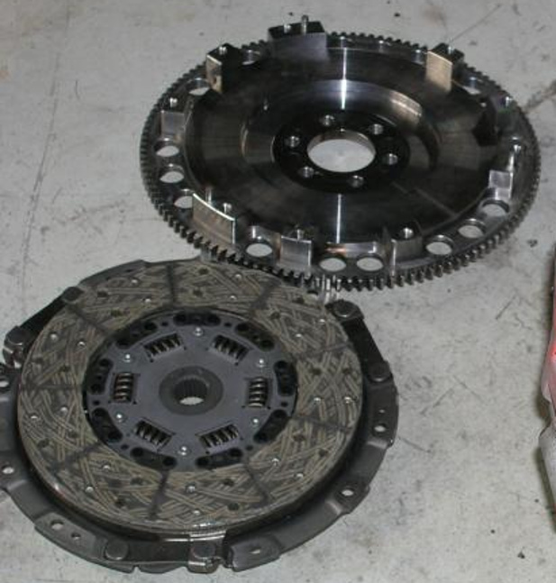

That's a work of art and wouldn't be out of place on a jet fighter.Many of the swappers here could use a source of adapter flywheels.
Is this the fellow that did this work?
http://www.odt.co.nz/sport/motorsport/3169...on-credits-team

veekry9   Like what you did with the 2+2.Immaculate in bla...   Jan 11 2015, 02:37 PM
returf   Like what you did with the 2+2.Immaculate in bl...   Jan 11 2015, 03:34 PM
veekry9   That's a work of art and wouldn't be out...   Jan 11 2015, 03:38 PM
returf   That's a work of art and wouldn't be out o...   Jan 13 2015, 02:42 AM
