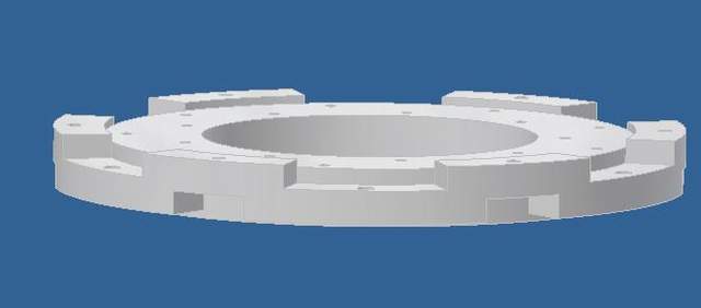

A link to a Northstar DOHC 32V + G6 TX install.
Immaculate work.
http://www.fiero.nl/forum/Forum3/HTML/000030.html
Flywheel adapter in cad.
