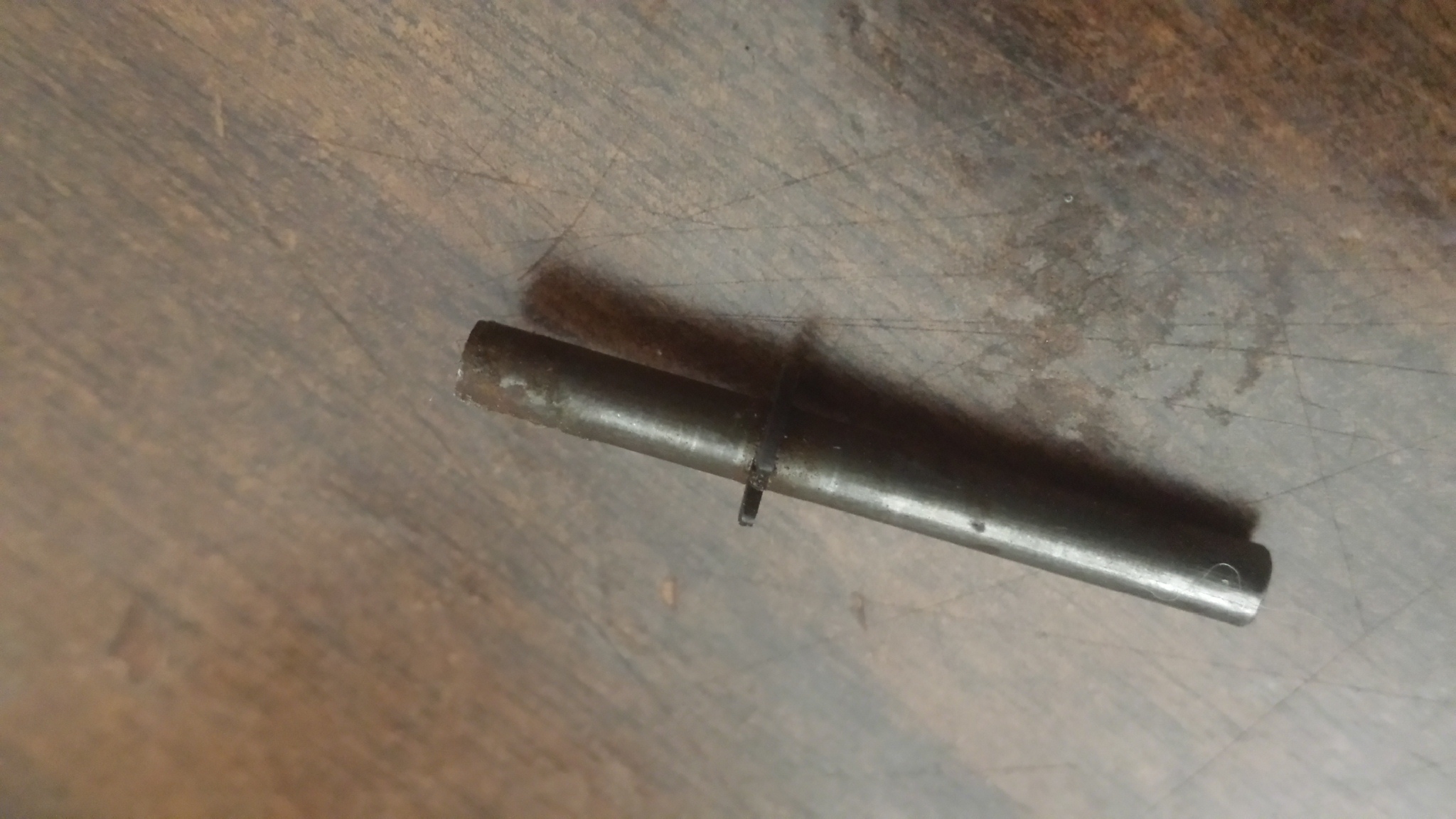

got a photo of the pin with the clip?
I'd hate to think the pin could get sucked into the moving parts! (IMG:style_emoticons/default/huh.gif) |

got a photo of the pin with the clip? I'd hate to think the pin could get sucked into the moving parts! (IMG:style_emoticons/default/huh.gif) I think i have one at the shop. I know you can buy the correct pin for about $ 7 from Pelican. Attached thumbnail(s) |
