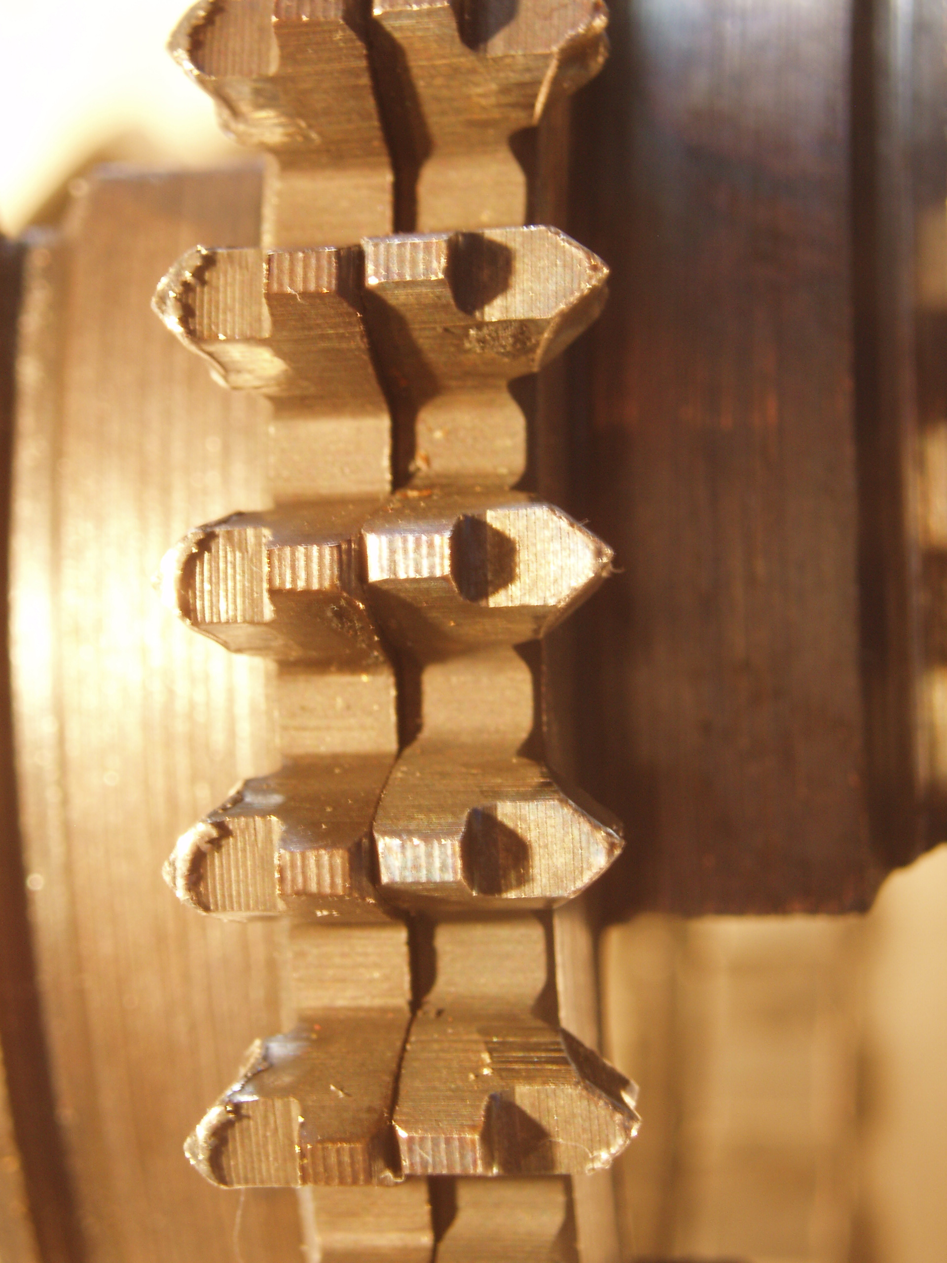

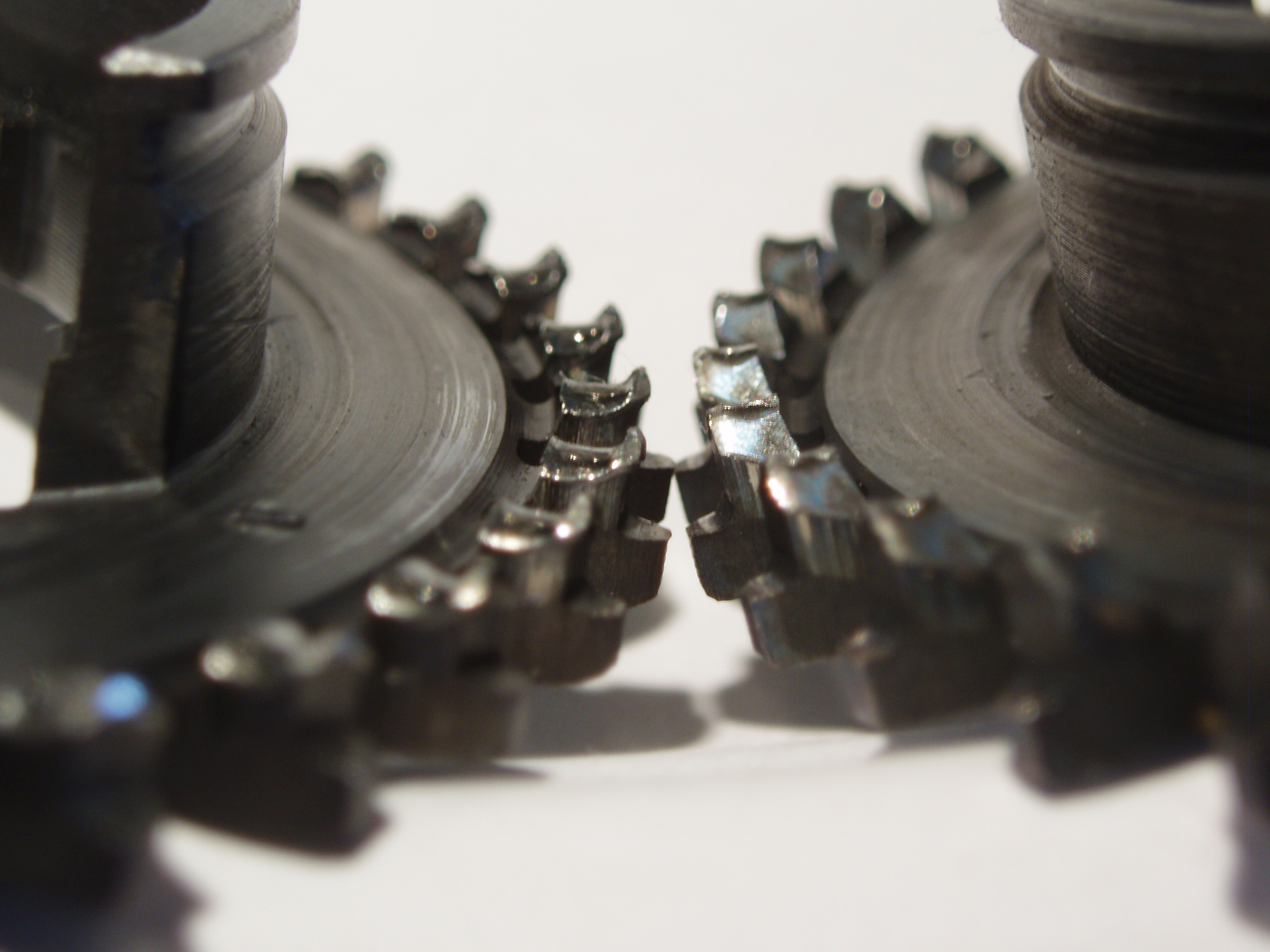

914bub Ok so George,Thepaintedman, inspired me to tear in... Jan 18 2015, 02:25 PM
Bartlett 914 Looks pretty bad. Dog teeth and no doubt the slide... Jan 18 2015, 02:48 PM
Jeffs9146 I am in Discovery Bay and I have a few boxes of sp... Jan 18 2015, 03:02 PM
dangrouche all is not lost; you can repair 1st/reverse slider... Jan 18 2015, 03:03 PM
914bub I got the parts out of my core transmission. They ... Jan 18 2015, 04:26 PM
Dr Evil That slider looks useable, clean it up to be sure.... Jan 18 2015, 08:31 PM
Dr Evil You will need to lock the trans in 1 and 5 to hold... Jan 18 2015, 09:42 PM
Dr Evil Both are shit. Sorry. The wear on the better one i... Jan 19 2015, 08:29 PM
