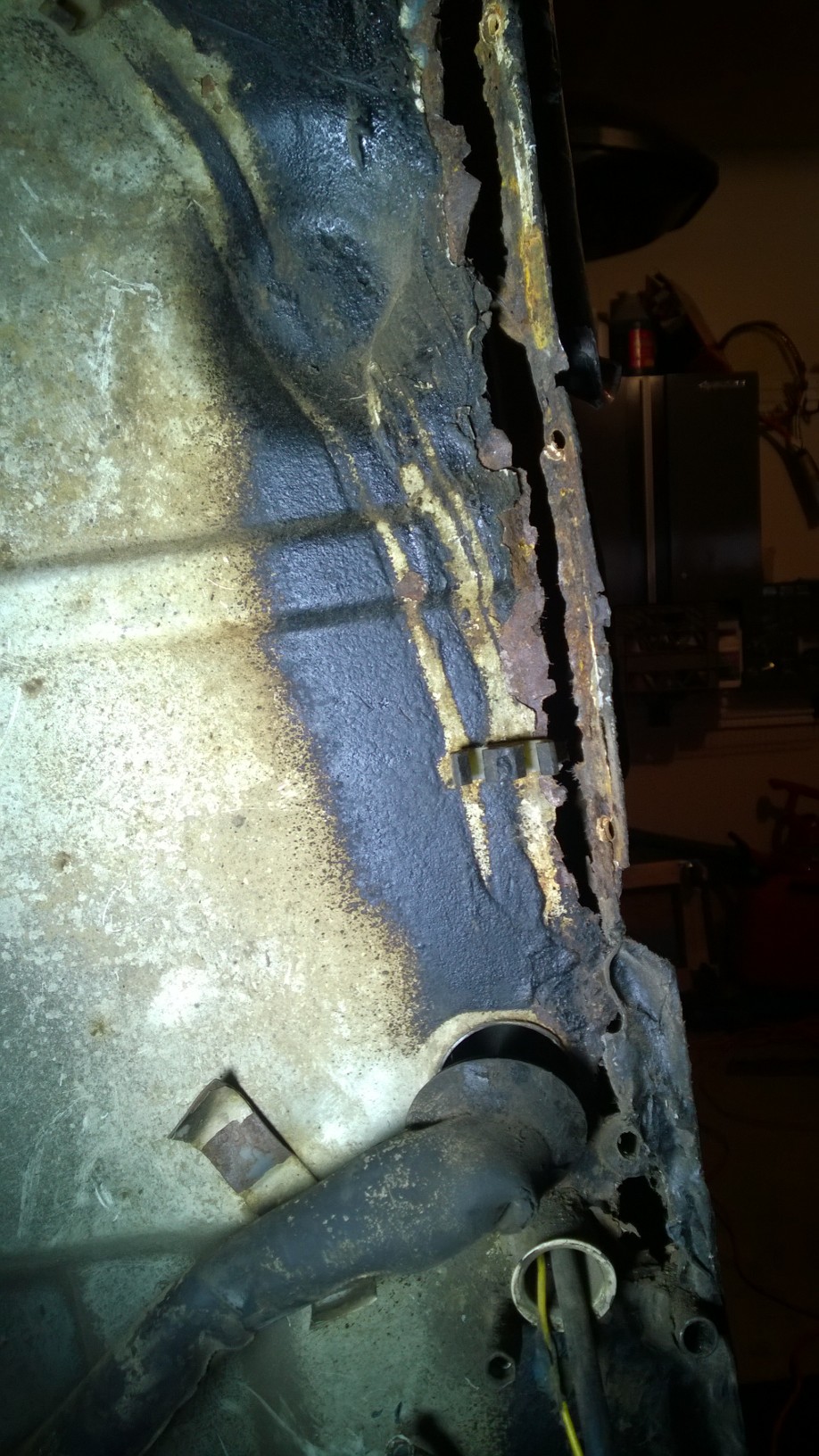

And, I found more rust. The floor pan and base of firewall is pretty well trashed. This is going to be a challenge as whatever fix I do is going to have to accommodate the cable outlets.
So now I'm removing the suspension console ear. I'm trying to drill out the spot welds, but it's slow going. Maybe I'll start grinding the welds off. Any suggestions to make this task any more pleasant? My intention is then to remove the outer suspension console piece and repair and clean that up. Hopefully make more progress tomorrow.

scotty b   There's no easy, pleasant, fast, or fun way to...   Jan 24 2015, 07:43 PM
BeatNavy   Thanks Scotty. My buddy has a plasma cutter - up i...   Jan 24 2015, 07:52 PM
