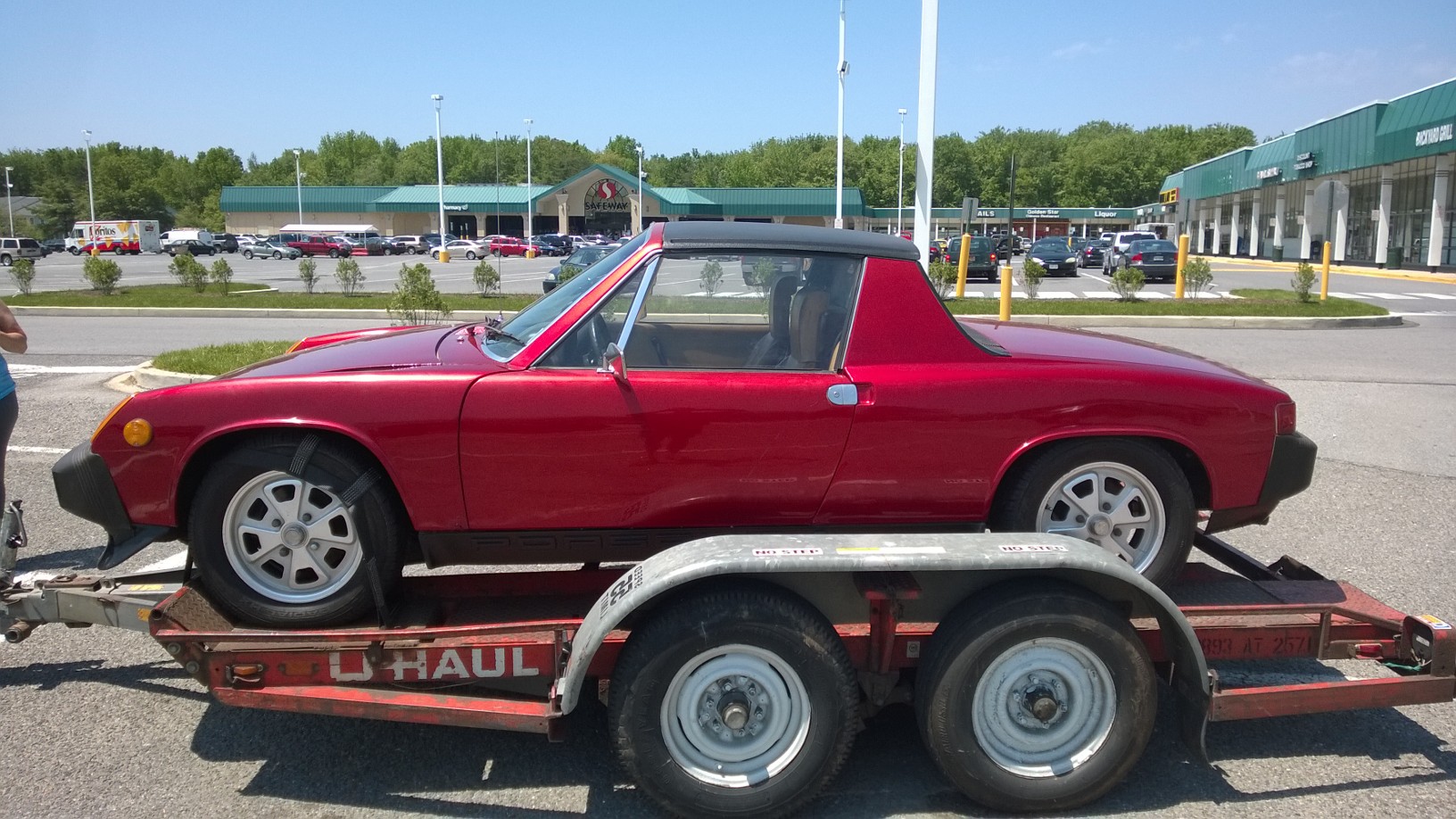

Ok, here goes. I picked up this '75 last April in lower Maryland. It was advertised as a 2.0, it has a 2.0 badge on the back, and it looked pretty good from a distance (or with beer goggles).
