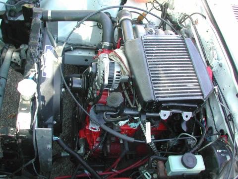

I've been slowly gathering steam on this. After talking to the folks at the G&R flesh roast,, I'd thought I'd share some pics and thoughts.
I don't want to do any major cutting on my conversion. My goal is to have 2 usable trunks, and a car that can be easily converted back to a stocker. There have been a few threads where the possibility/impossibility of an engine bay radiator. Here's my take on it. I believe that at 25+ mph there is a low pressure spot behind the back window. I think this will be enough to suck air up through the engine compartment.
I would love to hear some constructive criticism.
-Robert

Rotary'14   My cut-less conversion   Oct 23 2011, 06:09 PM
Rotary'14   This is how I am mounting my oil cooler. The PO o...   Oct 23 2011, 06:15 PM
sixnotfour   Nice !! You tell Us , Does it work ??   Oct 23 2011, 06:16 PM
Rotary'14   Nice !! You tell Us , Does it work ?? I...   Oct 23 2011, 06:20 PM
Rotary'14   I relocated my fuel pump to the front trunk and I ...   Oct 23 2011, 06:18 PM
Rotary'14   I almost forgot,,,, my radiator can swing open for...   Oct 23 2011, 06:23 PM
kg6dxn   Nice! If you have the radiator fans blowing up...   Oct 23 2011, 06:24 PM
sean_v8_914   Good to see you today where is the air burp/bleede...   Oct 23 2011, 06:30 PM
Rotary'14   Good to see you today where is the air burp/bleed...   Oct 23 2011, 08:14 PM
mark21742   I want to know more about this swap.....a lot more...   Oct 23 2011, 07:51 PM
Dave_Darling   You may find that the engine lid actually has a hi...   Oct 24 2011, 12:39 AM
Rotary'14   You may find that the engine lid actually has a h...   Oct 24 2011, 06:43 AM
bandjoey   What about the extra heat softening up the buytl h...   Oct 24 2011, 07:20 AM
nathansnathan   Hey, Rob, I was thinking more about this last nigh...   Oct 24 2011, 08:12 AM
matthepcat   I seem to remember a thread of someone doing an en...   Oct 24 2011, 08:59 AM
Rotary'14   I seem to remember a thread of someone doing an e...   Oct 24 2011, 09:19 AM
dakotaewing   I seem to remember a thread of someone doing an ...   Oct 24 2011, 09:38 AM
Andyrew   Overflow tank? This is a great idea, but I have ...   Oct 24 2011, 09:17 AM
Rotary'14   Overflow tank? This is a great idea, but I have...   Oct 24 2011, 09:25 AM
porsche913b_sp   Thats pretty cool thinking out of the box Robert. ...   Oct 24 2011, 10:25 AM
kg6dxn   Just remember, when a rotary overheats... It's...   Oct 24 2011, 10:26 AM
Andyrew   I was just thinking that a rotary probably wouldnt...   Oct 24 2011, 10:28 AM
JRust   I hope it works for you Robert. I worry about it b...   Oct 24 2011, 12:17 PM
Jeff Bowlsby   :)   Oct 24 2011, 01:47 PM
rick 918-S   :) :agree: with the engine tin in place. Other...   Jan 29 2015, 11:46 AM
Rand   My $.01 opinion is the natural airflow debate...   Oct 24 2011, 02:12 PM
Dave_Darling   Jeff's tuft testing photo there matches the pi...   Oct 24 2011, 05:22 PM
Rotary'14   Jeff's tuft testing photo there matches the p...   Oct 24 2011, 05:35 PM
kg6dxn   Jeff's tuft testing photo there matches the ...   Oct 24 2011, 06:29 PM
Vacca Rabite   :agree: flip the fans and put a GT lid over the ra...   Oct 24 2011, 09:01 PM
moparrob   :agree: flip the fans and put a GT lid over the r...   Oct 24 2011, 09:10 PM
Rotary'14   A GT style lid has always been in the plans, weath...   Oct 25 2011, 06:46 AM
