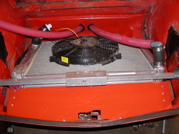

Radiator...
DONE
(minous wiring the fan...)

dan10101   Radiator... DONE (minous wiring the fan...)   Aug 30 2004, 09:27 PM
skline   Why does it look like its going to leak??? Are you...   Aug 30 2004, 11:26 PM
Andyrew   Oh the hoses arnt connected all the way.... air es...   Aug 30 2004, 11:55 PM
neo914-6   Scott, You must have missed the vented hood pic.....   Aug 31 2004, 12:08 AM
