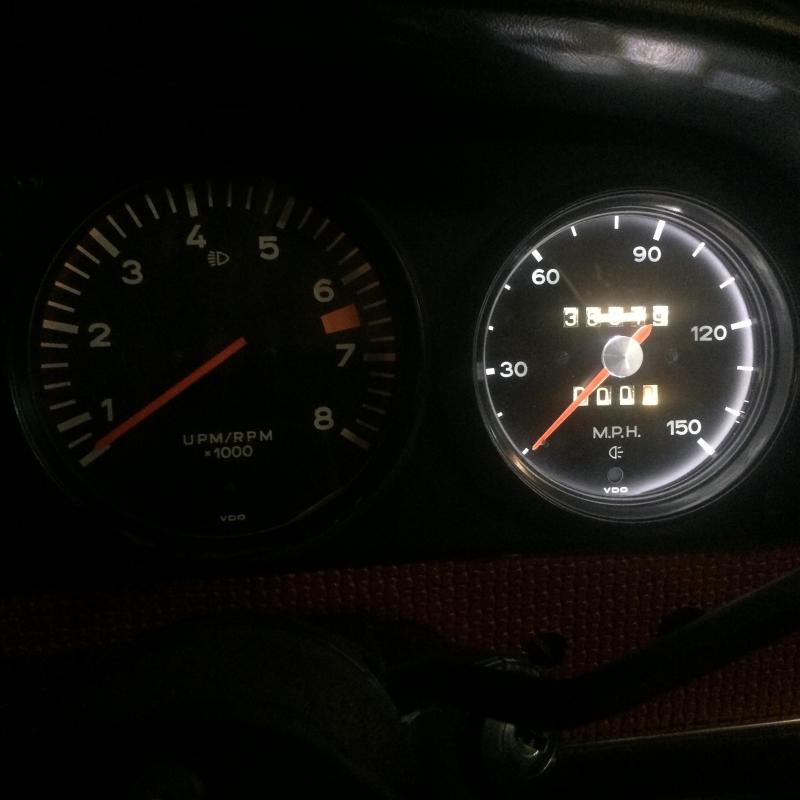

Finally got all the parts to start this great DIY project. One gauge down, two to go. Compared to the new LEDs on the speedo, the old bulbs on the tach don't even look like they're on.
(IMG:http://www.914world.com/bbs2/uploads_offsite/i2.photobucket.com-17027-1423794744.1.jpg)
