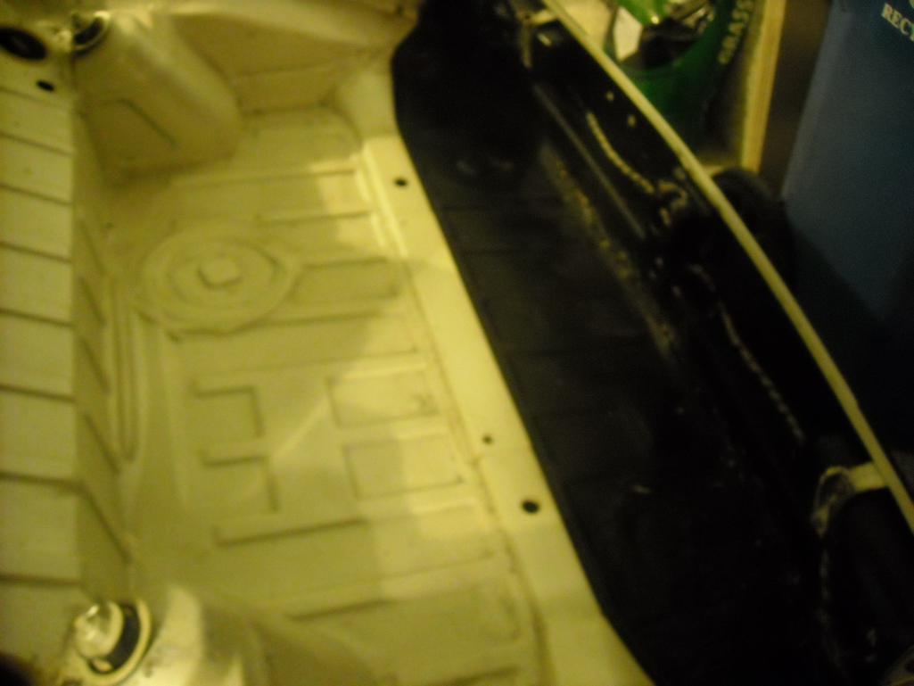

Well....starting looking at what I have a little closer today.
Very solid car for a '71.
But I think it spent most of its life in California....so I'm hoping very little rust.
I do see a new rear floor in the rear trunk.
Right now it's all painted black, so I'm sure there's rust issues there.
Also see the corners of the front windshield will need a little work as I see rust stains in the front trunk up under the dash. Nothing horrible, but it will definitely need to be addressed.
I've been told by the previous owner that the hell looks good except for a small quarter size hole that's already been repaired. I'll improve upon it.

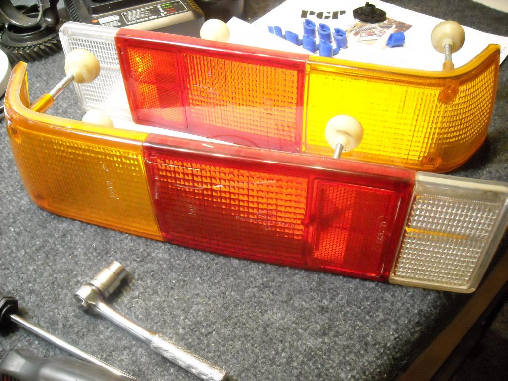

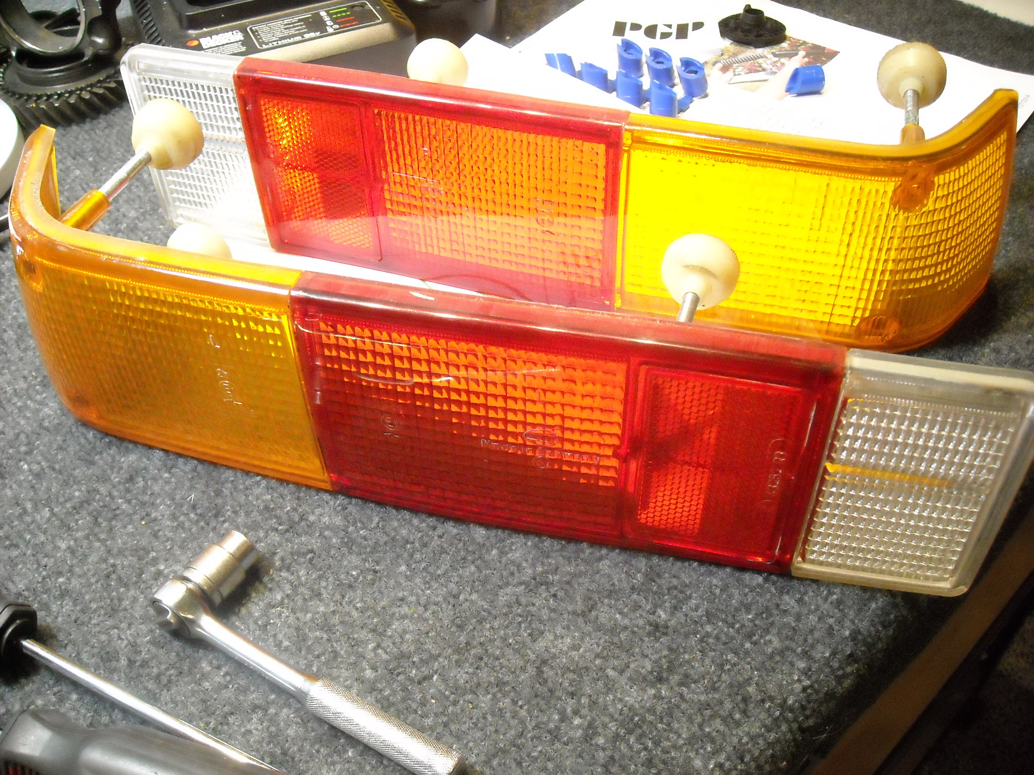

raynekat   You're seeing some of the Euro lens that came ...   Feb 12 2015, 10:12 PM

raynekat   NOS lens and reflectors off of Ebay Germany with s...   Jun 10 2016, 11:49 PM
