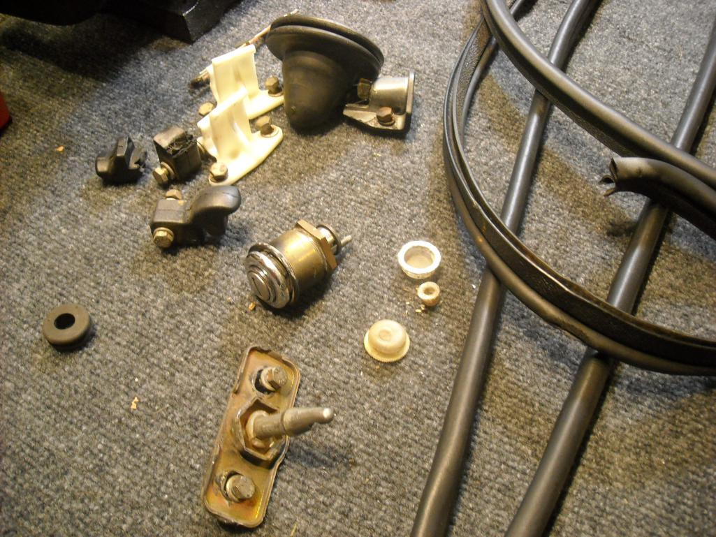

raynekat   Well....starting looking at what I have a little c...   Feb 12 2015, 10:10 PM
raynekat   You're seeing some of the Euro lens that came ...   Feb 12 2015, 10:12 PM
raynekat   So far all the rubber is like Kryptonite....or may...   Feb 12 2015, 10:14 PM
