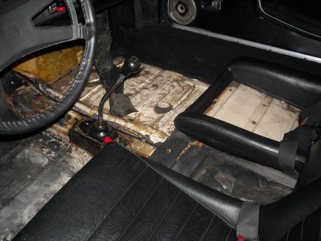

raynekat   Or interior.... Wow....it's difficult to add ...   Feb 12 2015, 10:26 PM
