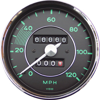

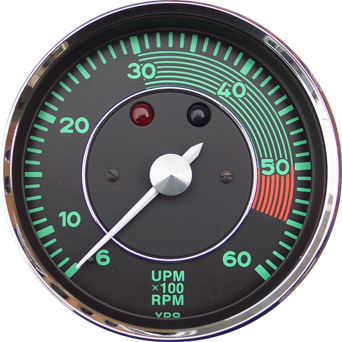

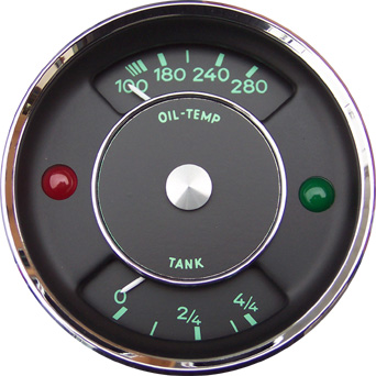

My plans are to do these instruments....
Ala 356 style.
