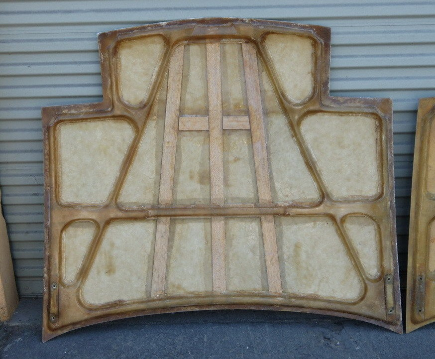

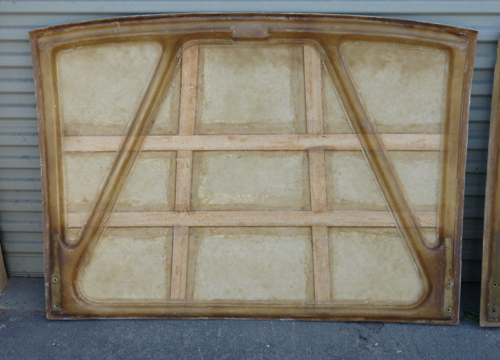

I'll do a set of the cool fiberglass/balsa wood front and rear deck lids from Aase just to keep the car light weight.
Along with the two toned front bumper.

raynekat   I'll do a set of the cool fiberglass/balsa woo...   Feb 12 2015, 10:36 PM

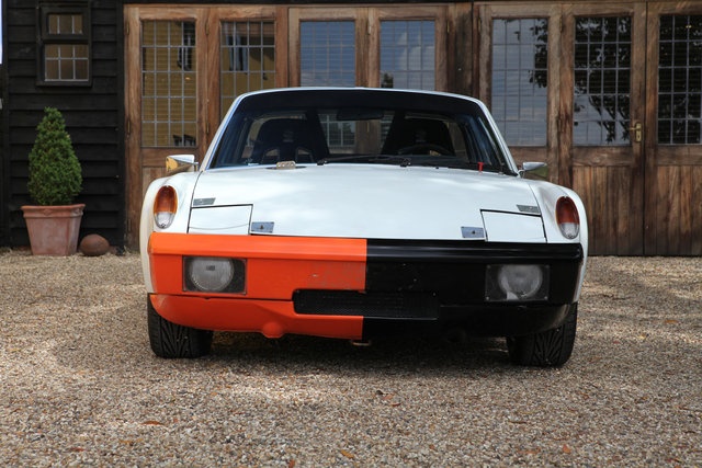

raynekat   So I'm thinking about a narrow body GT that is...   Feb 12 2015, 10:41 PM
raynekat   I love this car.... How close I get to it remain...   Feb 12 2015, 10:43 PM
