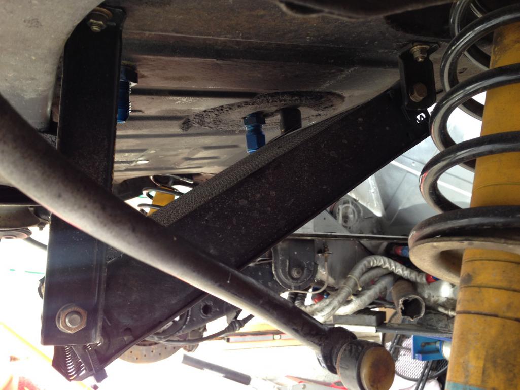

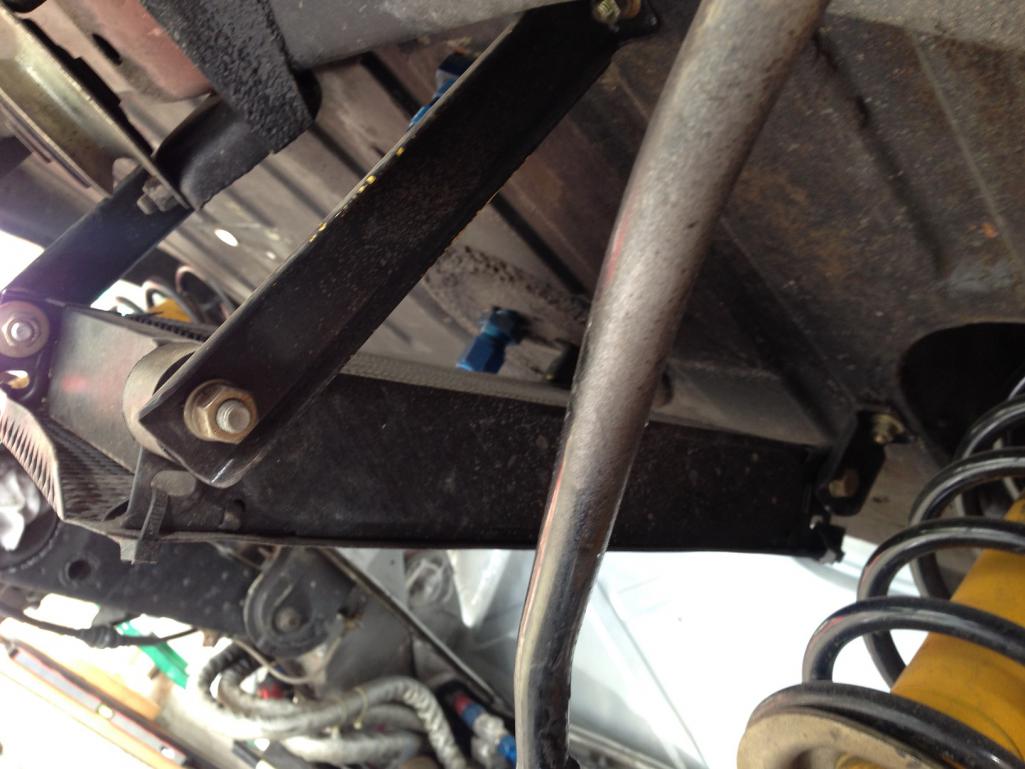

I attempted my 914-6 conversion with a 3.0L without running an external oil cooler. Some have said they have done it so I figured if I could save a grand of dollars that would be nice. But my extended freeway driving took it to around 240 and I didn't push it any further. So thus I caved and installed an external oil cooler.
Engine oil ouput line
Existing Remote Filter Mounted in Trunk
Mocal 25 Row, 235 Matrix Mounted
Braced Against Muffler Bracket
Fan Mounted
Electrical - Grounded to Transmission Ground
Relay Mounted - Main Power off Bus Bar, Ignition from Relay Board
Mocal Remote Oil Thermostat
Putting It Together
Finished!
Brings temps down to 190 @ idle
Steve
