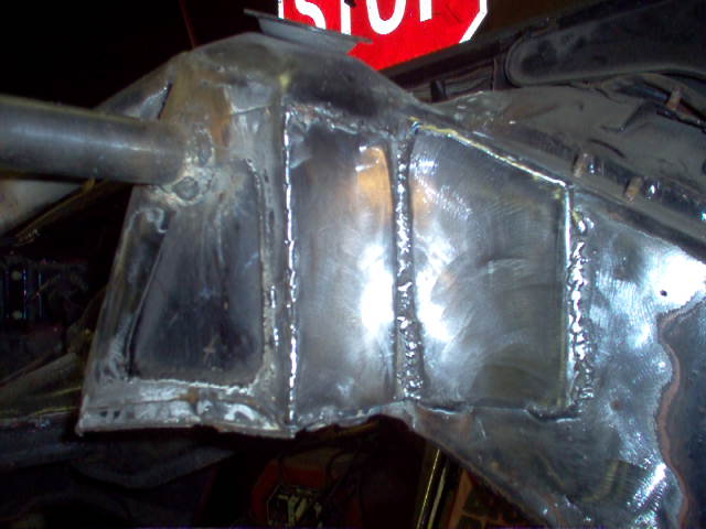

Thanks to Jeroen's thread I decided to cut away the body seam sealer and have a look at how the shock towers are fastened (not fastened?) to the body.Brad & Jeroen I can see how they would tear away after a while with stiff springs and racing stresses. (IMG:style_emoticons/default/smash.gif) Here are a couple of pics..........

Welded up one side lastnite (IMG:style_emoticons/default/welder.gif) ,now to the other side.........

Jeroen   Hey Steve, Looks good. Can you post some pics loo...   Aug 23 2004, 11:02 AM
SteveSr   Here ya go Jeroen,I fashioned a piece of sheet met...   Aug 23 2004, 01:40 PM

Jeroen   Steve, I hate to be a critic, but I think you nee...   Aug 23 2004, 05:14 PM
Cloudbuster   Could even more of that shock tower come off? Lik...   Aug 23 2004, 06:40 PM

SteveSr   Thinking too much is my problem :headbang: I,m a t...   Aug 24 2004, 08:42 AM
Cloudbuster   And now, for some unsolicited advice: A problem t...   Aug 24 2004, 12:47 PM
SteveSr   What about :welder: a piece of sheet metal on the ...   Aug 24 2004, 01:46 PM
Cloudbuster   <...   Aug 24 2004, 02:39 PM
Jeroen   Here's what I did on my previous chassis The x...   Aug 24 2004, 05:20 PM

Jeroen   Here's the rest of the x-braces The ones from ...   Aug 24 2004, 05:26 PM
SteveSr   I dove into the hellhole last nite with :sawzall:...   Aug 25 2004, 08:36 AM
SteveSr   one more................   Aug 25 2004, 08:37 AM
Jeroen   <...   Aug 25 2004, 08:40 AM
SteveSr   Yes! very surprised. Now on to the other side ...   Aug 25 2004, 10:34 AM

brant   Perhaps Chris or one of the other expert welders w...   Aug 31 2004, 12:50 PM
SteveSr   :agree: I'm a toolmaker,certainly not an exper...   Aug 31 2004, 01:34 PM
maf914   Steve and Jeroen, Thanks for the photos and expla...   Aug 31 2004, 02:43 PM
