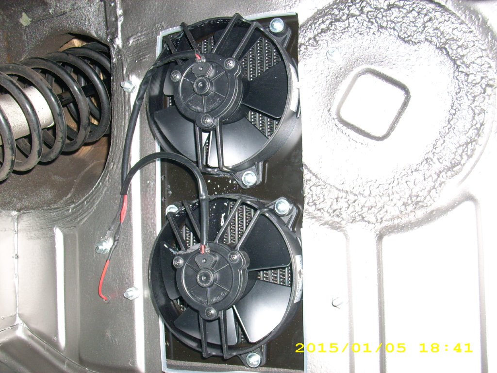

First off, I wanted to say a big "thanks" to everyone who takes the time to post stuff. I've solved a lot of problems by searching the site. I've mainly been lurking and working, but I thought I'd do some posting of my own to solicit some opinions before firing up the engine. Please be gentle in case I've screwed this up deluxe.
After seeing what had come before me, I wanted to mount the oil cooler so that it would have cool air from the top of the car, instead of hot air from the bottom of the car. I wanted to take advantage of the same "roof-suck" effect that theoretically draws air into the engine compartment. The downside is, I have to sacrifice the rear trunk. No big deal really - I'm not going cross-country in the car. Anyway, here is what I came up with: ![]() I'm using a Canton filter that's mounted in the engine compartment where the battery tray used to be: ![]() As for the oiling system, I mounted a Setrab dual-fan cooler in the rear trunk, and I'm using a 2-quart cable-actuated Accusump. I wanted the cooler to have cool air from the top of the car instead of the hot air from under the car, so I made holes in the trunk wall to the engine compartment. I've also installed a 180-degree thermostat (the fans turn on at 190 degrees). The lines from/to the engine itself are AN-8, but the system plumbing is all AN-10 to add volume and reduce flow resistance. The canister filter is positioned so the oil enters from the side, and air is purged out the top. Likewise, the cooler fills from the bottom so air is purged out the top as the oil rises up the slope of the trunk. Check valves are installed to stop oil drain-back into the engine, and to prevent the discharge from the Accusump from going “backwards” through the cooler and filter. ![]() Here's how I laid out the installation of the cooler: ![]() And the rough placement: ![]() I'm hoping this might help someone, and I'd also like to hear any words of warning from folks who know more than I do (it's a large demographic). Thanks! |

Oops. I forgot to post the photo of the cooler mounting taken from underneath. The red wire goes to the thermoswitch at the inlet of the cooler.

screenguy914 I appreciate you're thinking out of the box an... Feb 25 2015, 04:18 PM
MAD914 It's mostly the hot air discharge off of the e... Feb 25 2015, 05:13 PM
Dave_Darling The passages to and from the oil pump in a 914 are... Feb 25 2015, 05:21 PM
Cap'n Krusty It gets hot enough inside the rear trunk to fog ph... Feb 25 2015, 05:21 PM
Woody Nice setup. I am currently in the process of putt... Feb 25 2015, 05:23 PM
MAD914 Cap'n:
It's my hope that by adding additi... Feb 25 2015, 05:33 PM
Porschef Interesting. I'm planning on installing a cool... Feb 25 2015, 06:02 PM
patssle Very nice. I was considering that for my /6 but en... Feb 25 2015, 06:06 PM
MAD914 I've seen the engine-lid mountings too, but wa... Feb 25 2015, 06:07 PM
Jetsetsurfshop Do you plan on running this car at the track? I as... Feb 26 2015, 07:21 AM
stugray
The simple fact is that the clean air up front is... Feb 26 2015, 09:44 AM
MAD914 It's really a street car, but I'd love to ... Feb 26 2015, 12:19 PM![]() ![]() |
