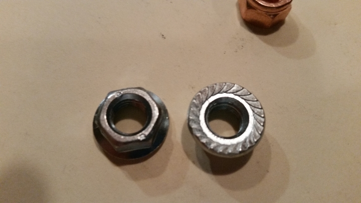

I found these when I was installing the 914 motor into my 68 fastie. They have a 12mm head and are flanged. The flanged surface has locking ridges. I don't know of anyone using something like this so I'm keeping an eye on them. It's been almost 2000 mi. and all is well so far.
(IMG:http://www.914world.com/bbs2/uploads_offsite/i936.photobucket.com-85-1425445437.1.jpg)
Above you can see one of the copper plated nuts with slit for locking. I bought a set of those too in case I need to go back but I don't like them.
