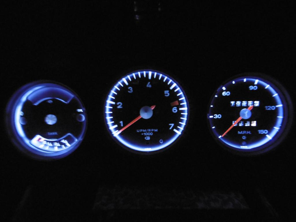

Many of us have issues with the inadequate lighting on our gauge cluster. This is a tutorial on how to increase the lighting for the DIY'er and for under 20 bucks.
Euro911 was nice enough to be the guinea pig, in which he donated his gauges for this build. I rate the skill level at around a 3. 1 being easy (adding blinker fluid) and 10 (setting up valve geometry).
1st step, remove the combo/speedometer/tach from your car. Alrighty, easy enough.
2nd step, drink a beer or two. This is somewhat unnerving and for the few it may turn you off. However, this isn't all that bad. We need to remove the bezel trim rings. I'm sure there is a machine out there that cost 15k, that will do this in about 10 seconds but we will use a small screwdriver. The first time I did this (my gauges) it took around 40 mins each, and I had a good size blister on my index finger. You will get a feeling that you are absolutely ruining these rings, but your not. Wedge the screw driver in between the bezel and the gauge can. Once your in, lightly twist back and forth the screw drive in situ pushing in a forward direction. By the time you get to the third gauge, you'll be a pro! I also found that it is unnecessary to uncrimp the entire circumference of the bezel ring. Once you get 3/4 around, the last 1/4 will pop off.
Now that these ring are off, go ahead and remove the insides. The tach will have 4 brass screws and the odometer will have 2. The combo gauge will have either 4 or 8 screws depending on the year.
Now that the inner guts have been removed, you should have 3 empty cans like this
We will need to clean the inside of these cans, for the best adhesion of the LED lights in a future step. I didn't use anything special, good old windex spray should suffice.

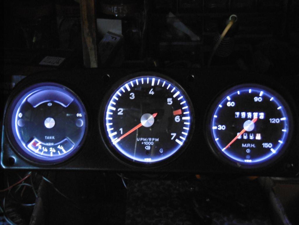

... and almost 2 years since Tim upgraded a set of gauges for me (the ones you saw him modify in this very thread), I finally installed them into a panel and applied power to them. These gauges are actually for my wife's '71, but I thought I'd try them out in the 'BB' until her car is ready for them (IMG:style_emoticons/default/happy11.gif)
These are sitting on my work bench right now and illuminated with 14 volts from a DC power supply.
They shut off at approx 9 volts and at 10~11 volts, they're very pleasant to look at, so I'll adjust the dimmer control to achieve that illumination setting after they're installed in the car.
Thanks again, Tim (IMG:style_emoticons/default/beerchug.gif) ... I'll finally be able to see these at night (IMG:style_emoticons/default/smile.gif)
