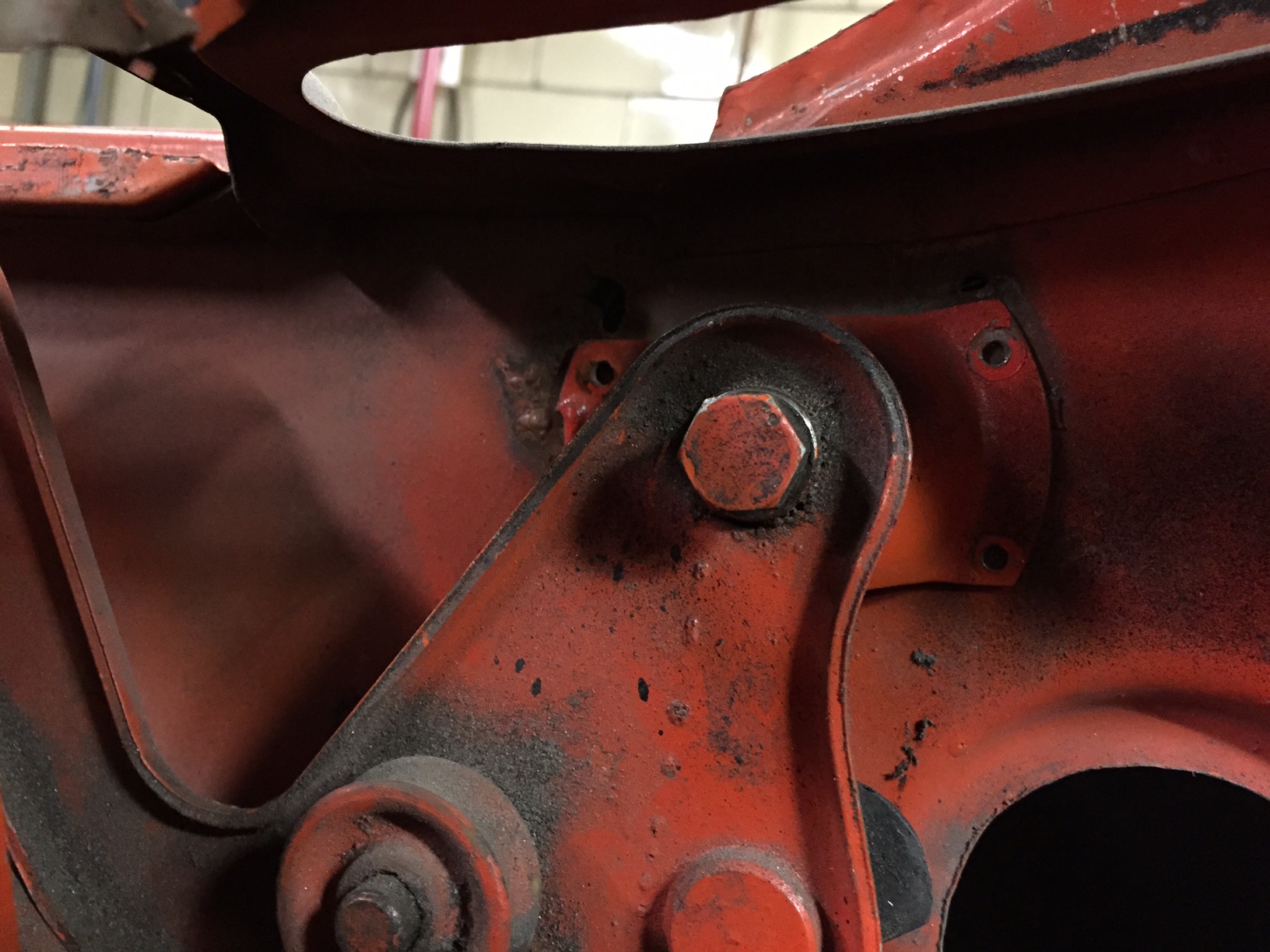

As you can see from the photo the mounting ear for my rear trunk was just screwed into the body. Both sides are screwed on but I would assume that they should be welded onto the body.
I don’t believe that that they are currently located correctly either. Does anyone know if there is a measurement for aligning these mounting ears?

rgalla9146   I don't know where you can get dimensions for ...   Mar 10 2015, 08:12 AM
OllieG   ...put the lid on and adjust to proper fit starti...   Mar 13 2015, 01:51 AM
jkb944t   I was hoping to avoid reassembling the trunk and e...   Mar 12 2015, 06:01 AM
jkb944t   Fortunately the PO just screwed them in so moving ...   Mar 13 2015, 06:51 AM
