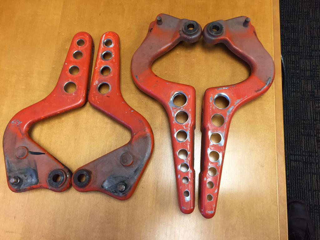

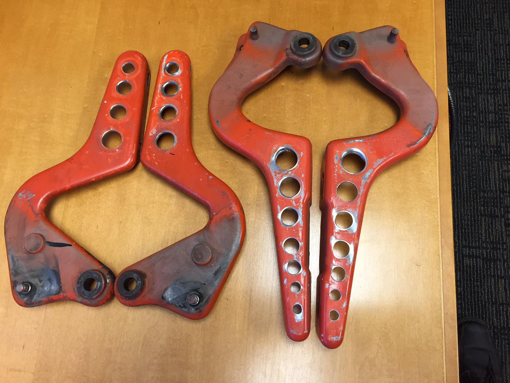

I was hoping to avoid reassembling the trunk and engine bay lid but that may be my only choice if these dimensions aren’t documented.
I did manage to get the hinges drilled for lightness but truthfully mostly just for the cool look!
