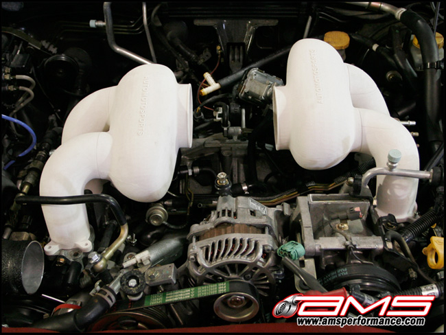

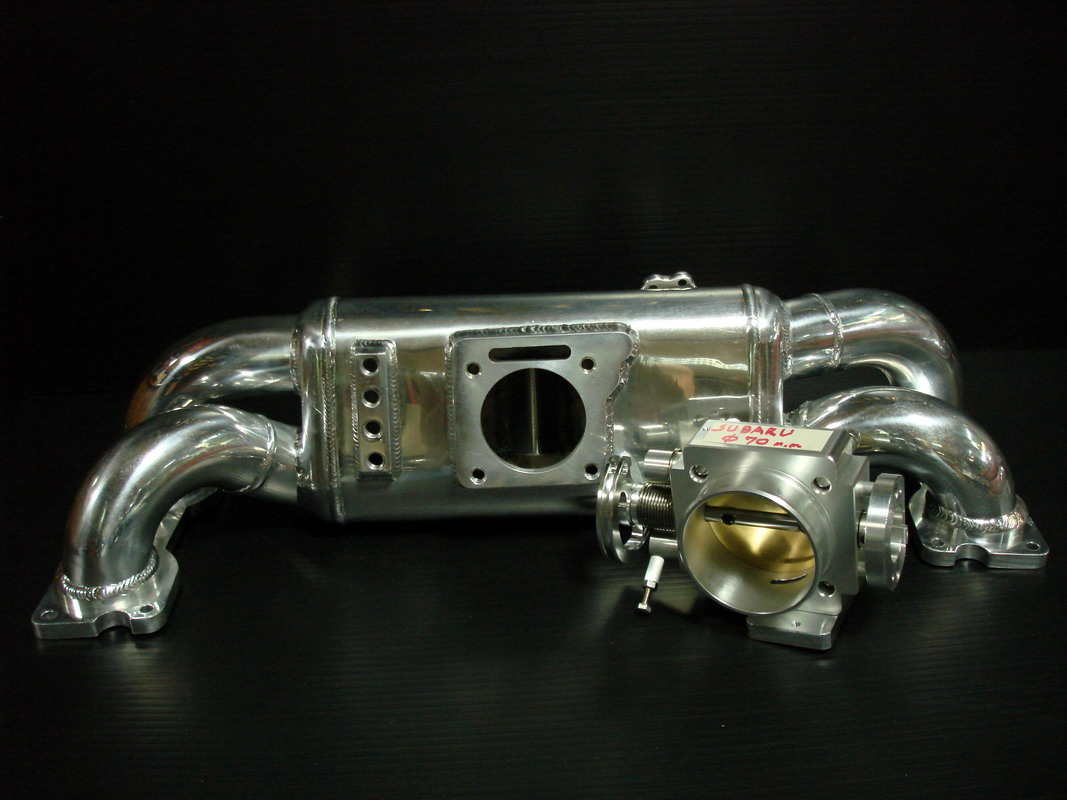

If you notice on the 911 engine, they are using individual throttle plates for each cylinder, that is from a Singer 911, and I'm guessing not a stock or factory setup.(?)
Looking at the Subaru stuff, I found some interesting things:
