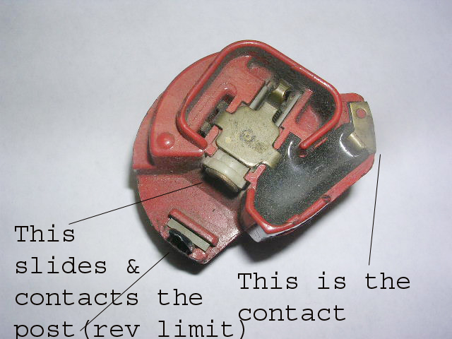

image of "bump rotor" attached
(IMG:http://www.914world.com/bbs2/uploads_offsite/i239.photobucket.com-1696-1427208330.1.jpg)
Maybe you have solved it, but thought I would add the image.

Dave_Darling   As I said on the Bird board, the red mark--the bra...   Mar 24 2015, 08:56 AM
SLITS   The dizzy needs to be rotated counter clockwise un...   Mar 24 2015, 01:41 PM
bcheney   The dizzy needs to be rotated counter clockwise u...   Mar 24 2015, 02:50 PM
SLITS   [quote name='SLITS' post='2164917' date='Mar 24 2...   Mar 24 2015, 03:23 PM
