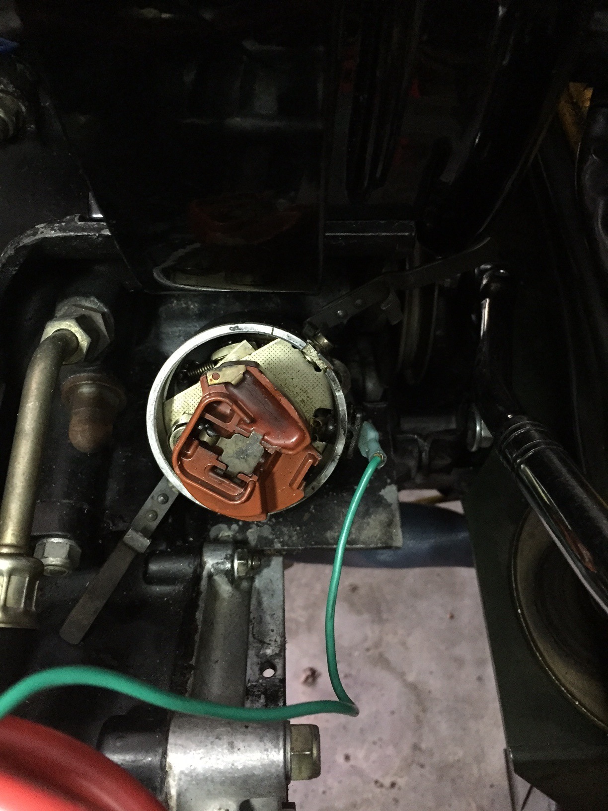

image of "bump rotor" attached
(IMG:http://www.914world.com/bbs2/uploads_offsite/i239.photobucket.com-1696-1427208330.1.jpg)
Maybe you have solved it, but thought I would add the image.

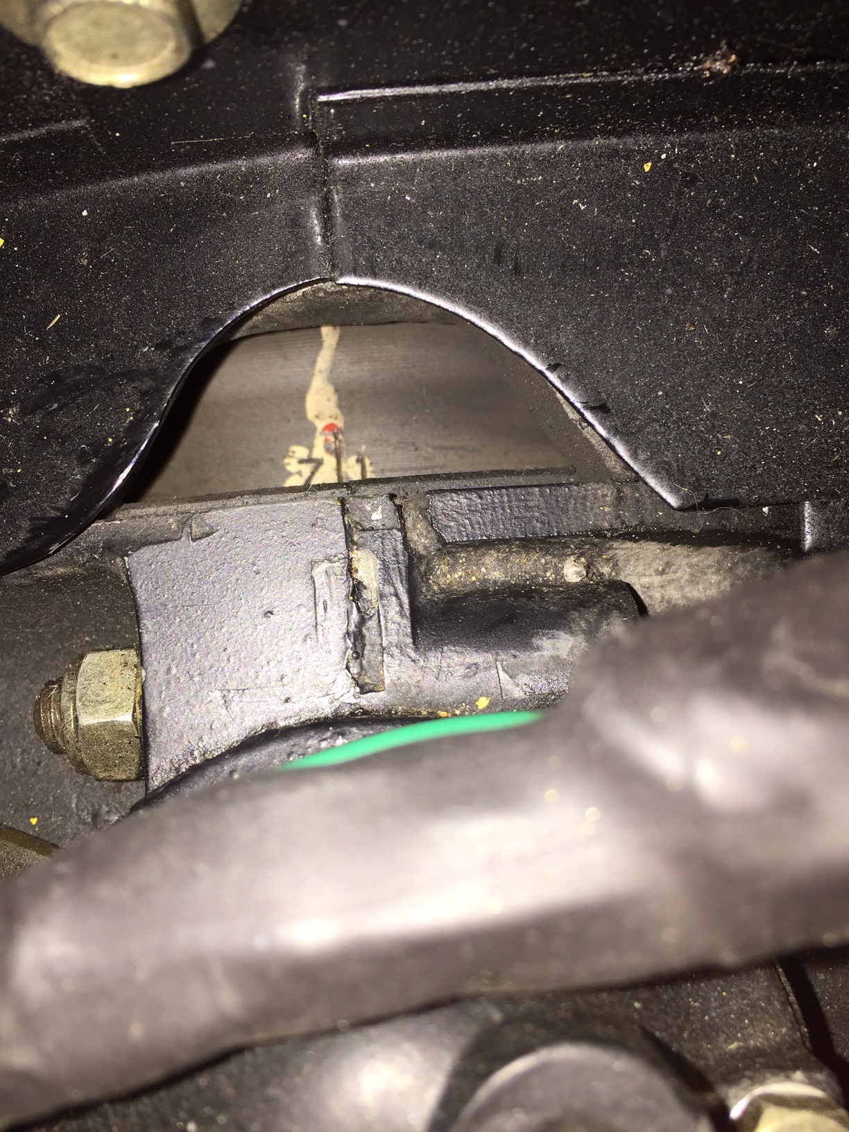

Ok rotated the crank towards the drivers side 360 degrees and this is what everything looks like now. Thoughts?

SLITS   It appears the rotor is pointed at #4. At TDC (Z1...   Mar 23 2015, 06:17 PM
bcheney   It appears the rotor is pointed at #4. At TDC (Z...   Mar 23 2015, 06:32 PM
rgalla9146   Hold on there ! Continue to rotate the cran...   Mar 23 2015, 06:46 PM
rgalla9146   Doh ! Slits done covered it while I had my...   Mar 23 2015, 06:50 PM
SLITS   The rotor needs to point to your white arrow WHEN ...   Mar 23 2015, 07:18 PM
bcheney   The rotor needs to point to your white arrow WHEN...   Mar 23 2015, 07:22 PM
fixer34   Been a while since I've done this, but if I re...   Mar 23 2015, 07:47 PM
SLITS   As stated before, the leading edge of the rotor .....   Mar 23 2015, 08:56 PM
SLITS   image of "bump rotor" attached http://w...   Mar 24 2015, 08:45 AM
bcheney   image of "bump rotor" attached [url=ht...   Mar 24 2015, 09:00 AM
bcheney   ..   Mar 24 2015, 09:04 AM
mskala   I can't remember for sure, but I think what ha...   Mar 24 2015, 10:41 AM
Dave_Darling   As I said on the Bird board, the red mark--the bra...   Mar 24 2015, 08:56 AM
SLITS   The dizzy needs to be rotated counter clockwise un...   Mar 24 2015, 01:41 PM
bcheney   The dizzy needs to be rotated counter clockwise u...   Mar 24 2015, 02:50 PM
SLITS   [quote name='SLITS' post='2164917' date='Mar 24 2...   Mar 24 2015, 03:23 PM
