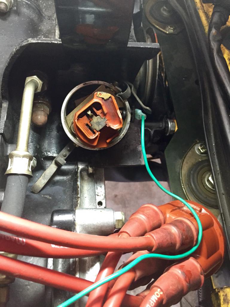

Just posted this on the Bird Board...Let me know if you can help.

The dizzy needs to be rotated counter clockwise until the leading edge of the contact is in line with the mark in the distributor. This assumes you are on the compression stroke of #1 cylinder.
If you do not have enough swing in the dizzy to accomplish the task, you will have to pull the dizzy up and rotate the rotor clockwise hopefully one tooth on the drive gear and then rotate the dizzy to line up the mark.
Post above says the same thing in essence.

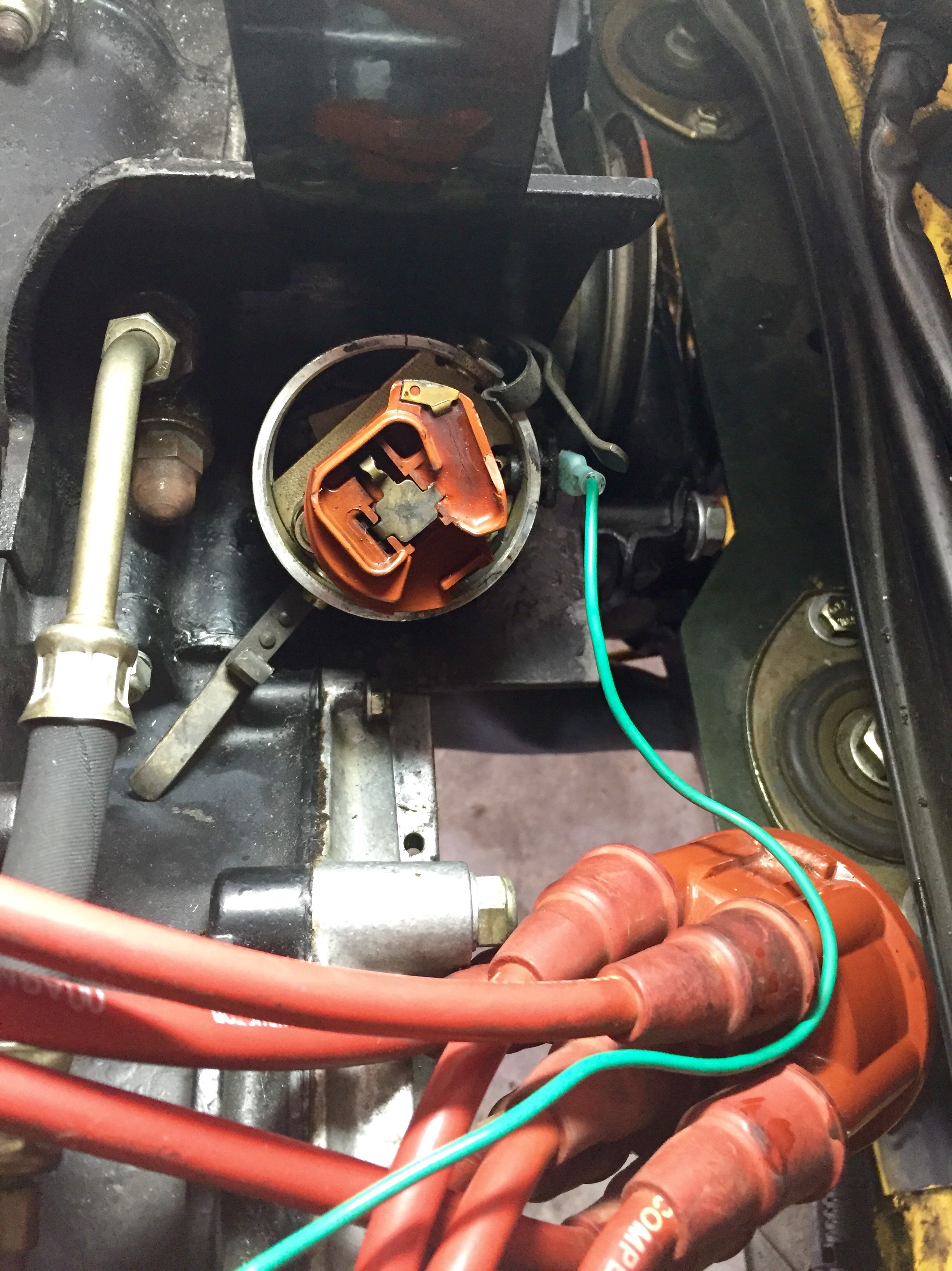

Ok here is where I've ended up now after taking a long lunch!
