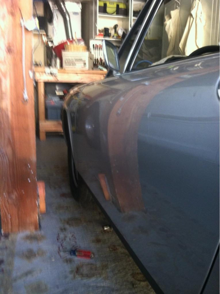

Took the Sills off the other day, Found the only real rust the car has on the jack point.
Easy enough to fix.

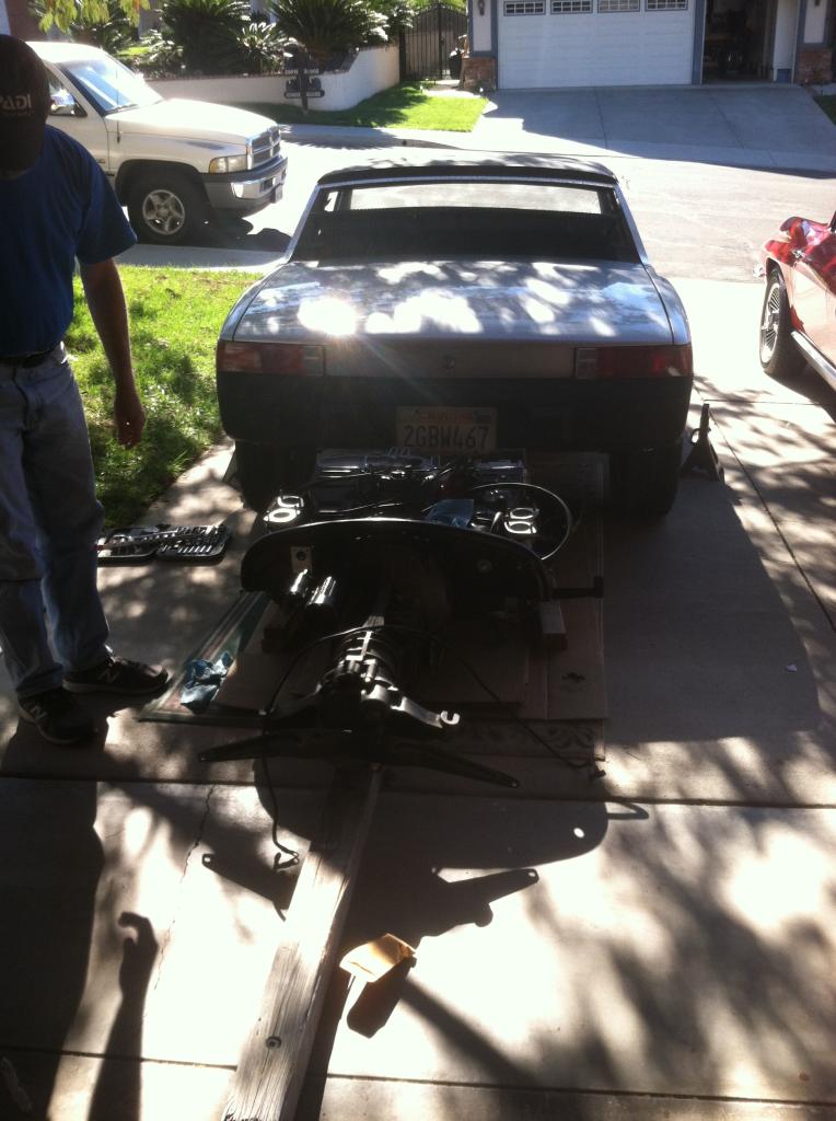

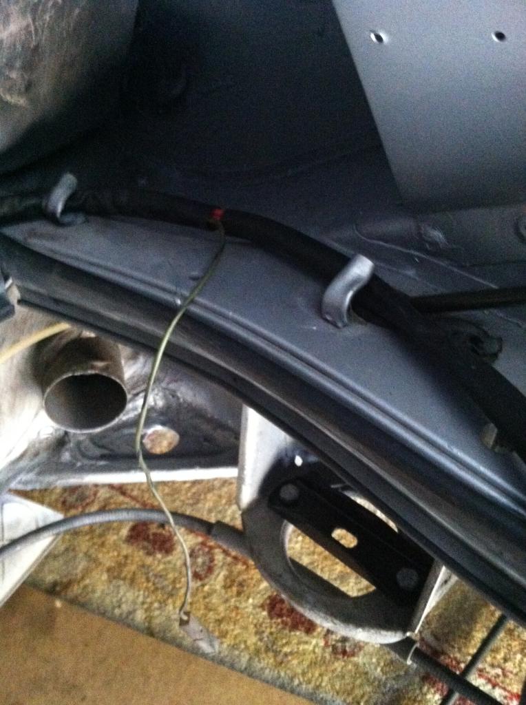

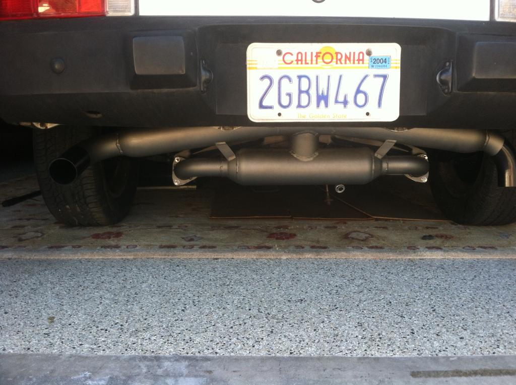

Cleaned up the engine bay and re did parts of the wiring harness in prep for putting the engine in.
(IMG:http://www.914world.com/bbs2/uploads_offsite/i821.photobucket.com-16526-1427783327.3.jpg)

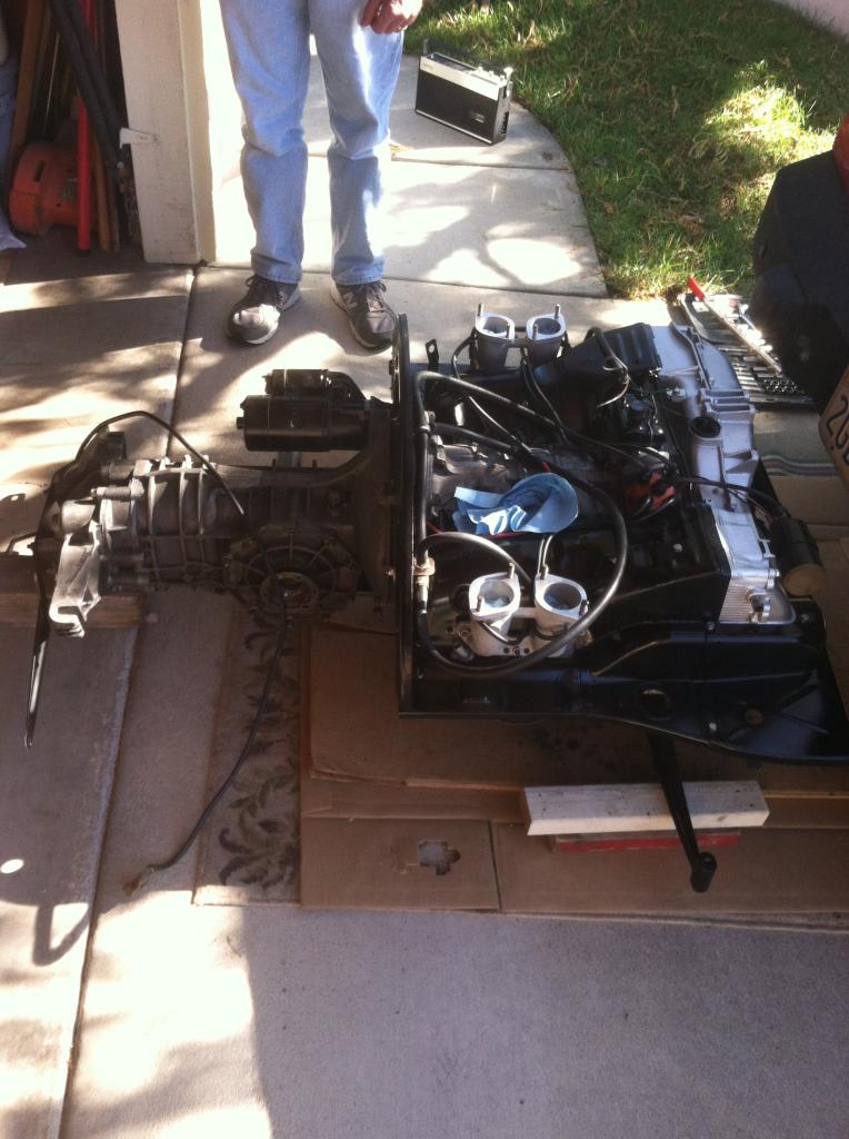

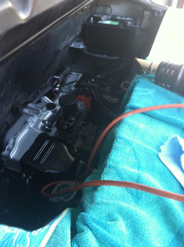

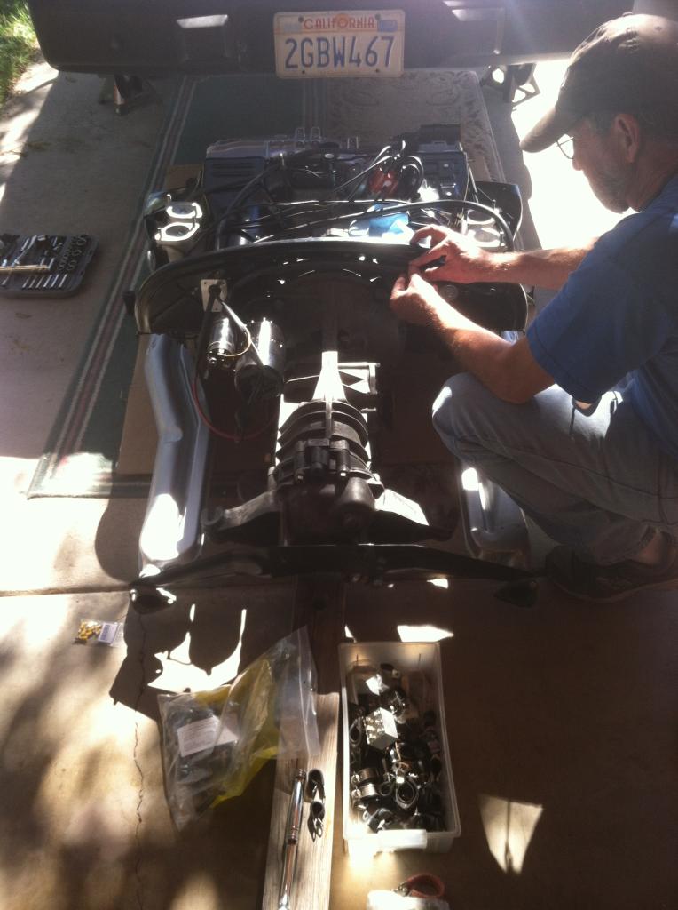

Time to put the engine in
(IMG:http://www.914world.com/bbs2/uploads_offsite/i821.photobucket.com-16526-1427783327.4.jpg)
(IMG:http://www.914world.com/bbs2/uploads_offsite/i821.photobucket.com-16526-1427783327.5.jpg)
(IMG:http://www.914world.com/bbs2/uploads_offsite/i821.photobucket.com-16526-1427783327.6.jpg)
(IMG:http://www.914world.com/bbs2/uploads_offsite/i821.photobucket.com-16526-1427783328.7.jpg)

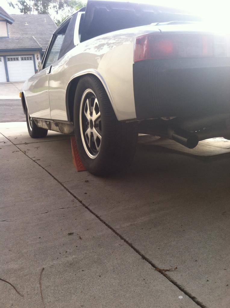

And its in.
(IMG:http://www.914world.com/bbs2/uploads_offsite/i821.photobucket.com-16526-1427783328.8.jpg)

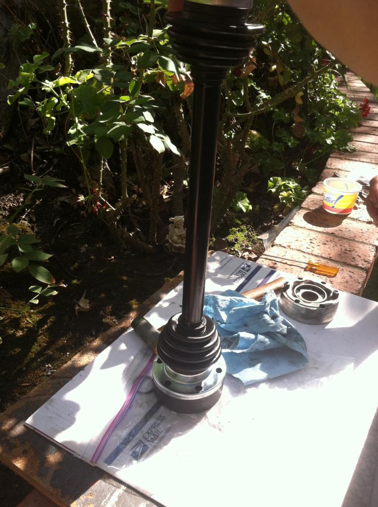

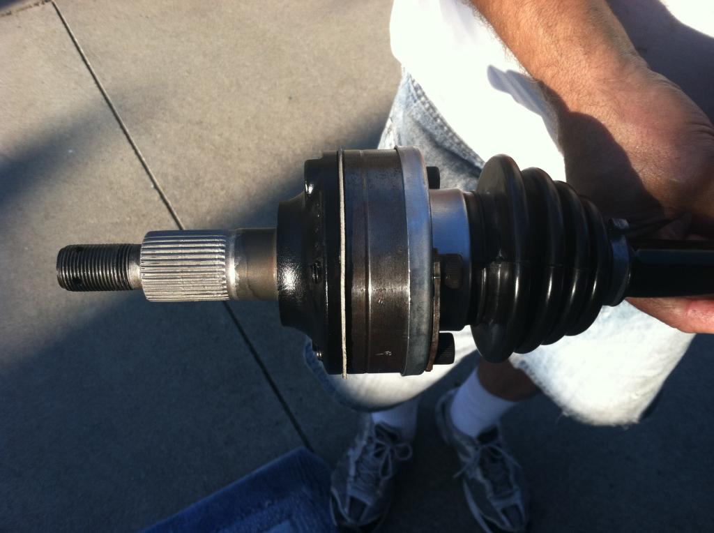

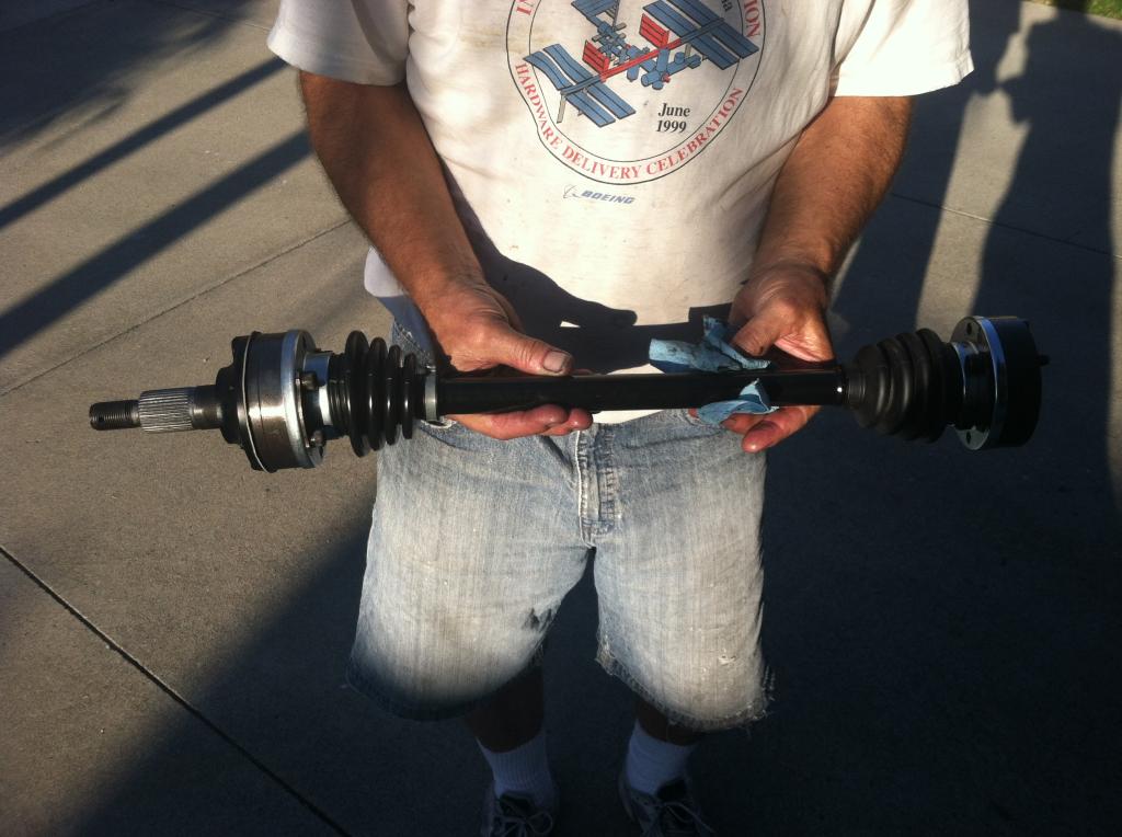

Time for axles
(IMG:http://www.914world.com/bbs2/uploads_offsite/i821.photobucket.com-16526-1427783328.9.jpg)
(IMG:http://www.914world.com/bbs2/uploads_offsite/i821.photobucket.com-16526-1427783328.10.jpg)
So the shafts and stubs were glass beaded then painted. got new boots and gaskets for them and fully anti siezed the splines.
What a pain they are to put in.
(IMG:http://www.914world.com/bbs2/uploads_offsite/i821.photobucket.com-16526-1427783329.11.jpg)
(IMG:http://www.914world.com/bbs2/uploads_offsite/i821.photobucket.com-16526-1427783329.12.jpg)
