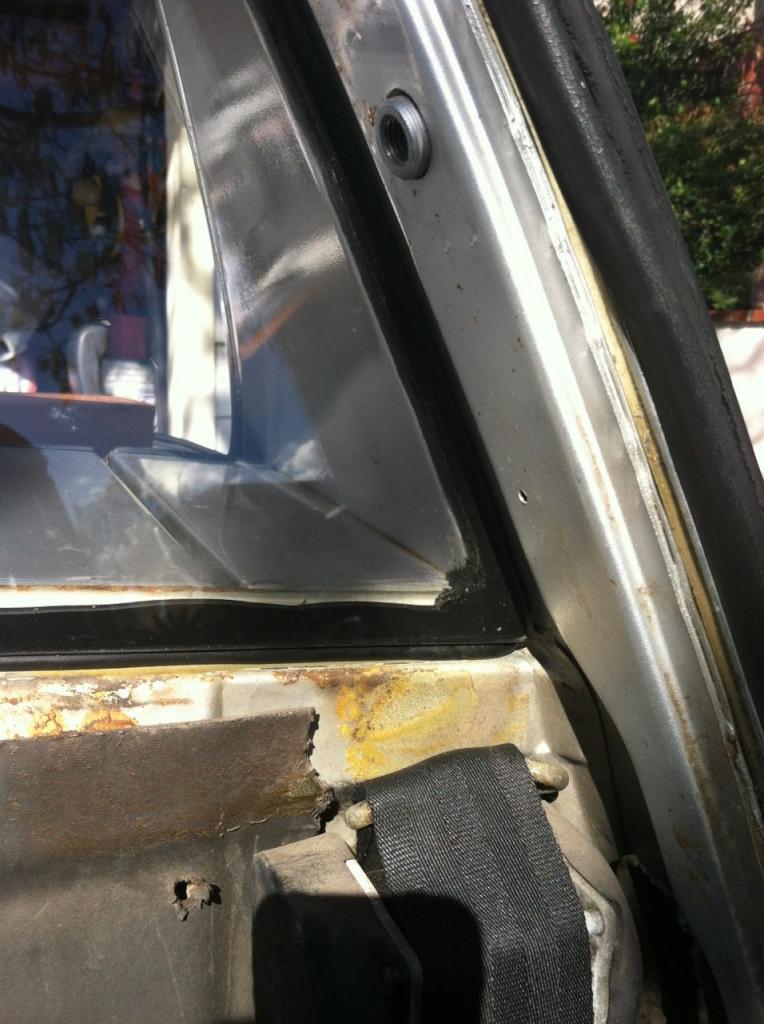

Had to re seal the rear window, it was the cause of my floor pan rust. Stupid owner had the car painted before me then they never put it back in properly.

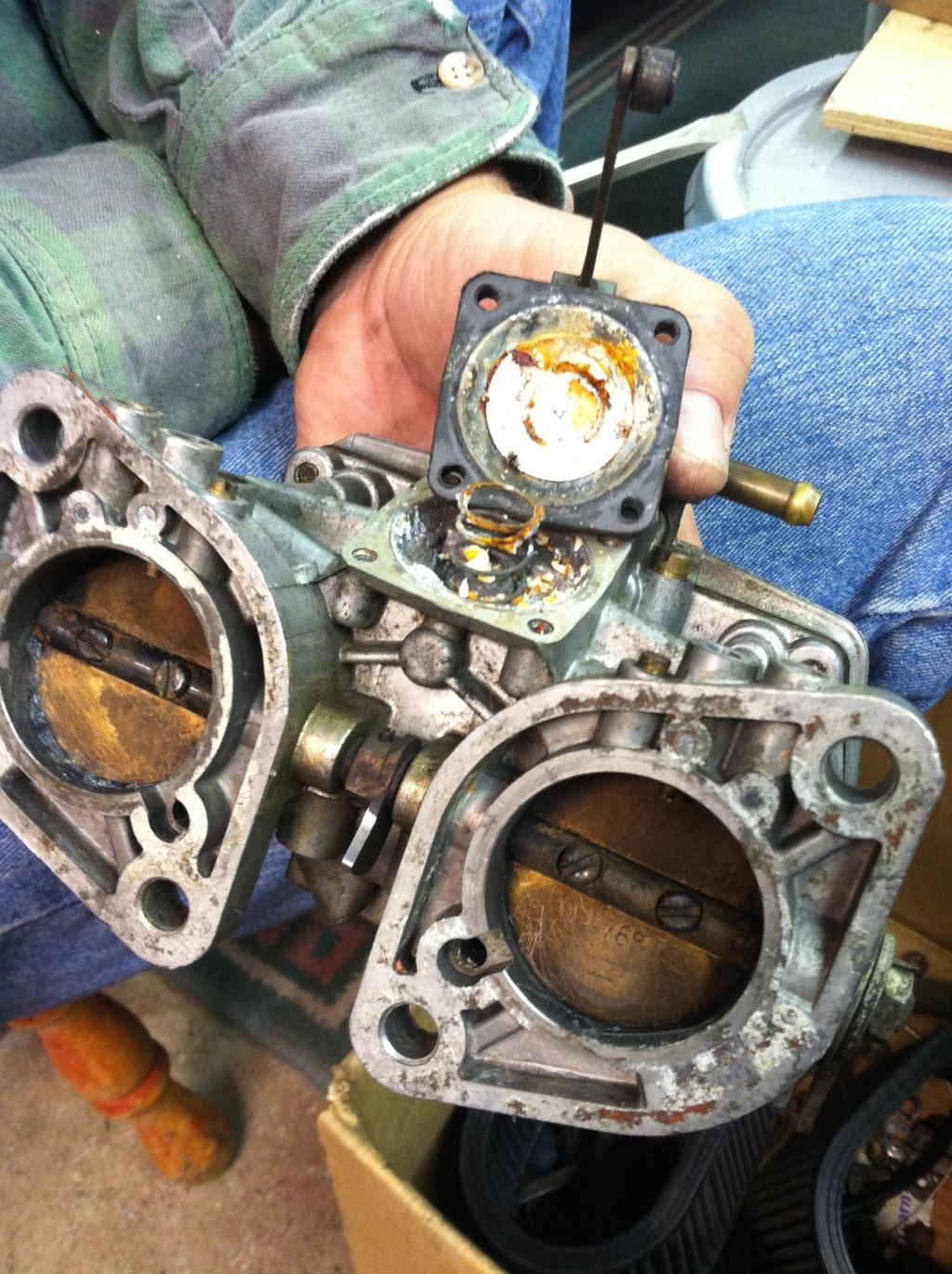

Doing some carbs for another 914 friend. He said they only sat outside for a little bit.
Yeah right.

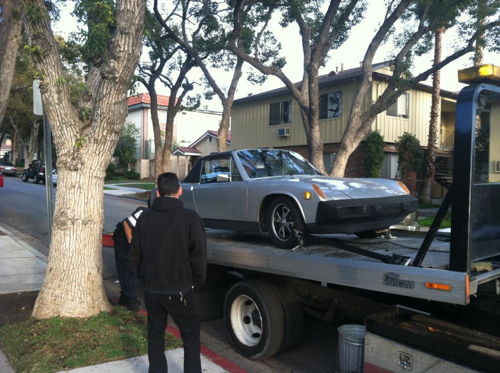

Drove my car to go see my good friend Arthur, Of course since i was 57 miles from home the car decided it did not want to shift at all. First second and occasionally 3rd was not going to get me home. Since i had no idea what the problem was i was hesitant to drive it lest their be loose something in the trans.
Onto the tow truck we go. (Thank you Arthur)

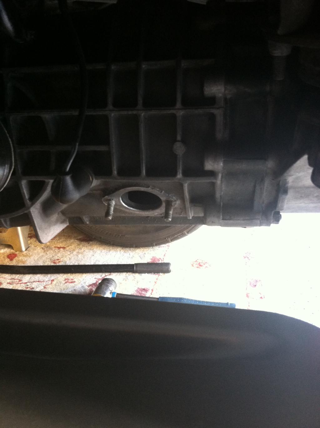

The cause, This is supposed to have bushings in it, They decided that right then was a good time to demand to be replaced. Easy enough to fix, gave me a excuse to re paint my shifter rod that was scratched up from the original install.
(IMG:http://www.914world.com/bbs2/uploads_offsite/i821.photobucket.com-16526-1427783446.6.jpg)
But not before i tore the shift console out of the trans to check the roll pin on the selector forks... UGH least it did not leak after i re installed them.
