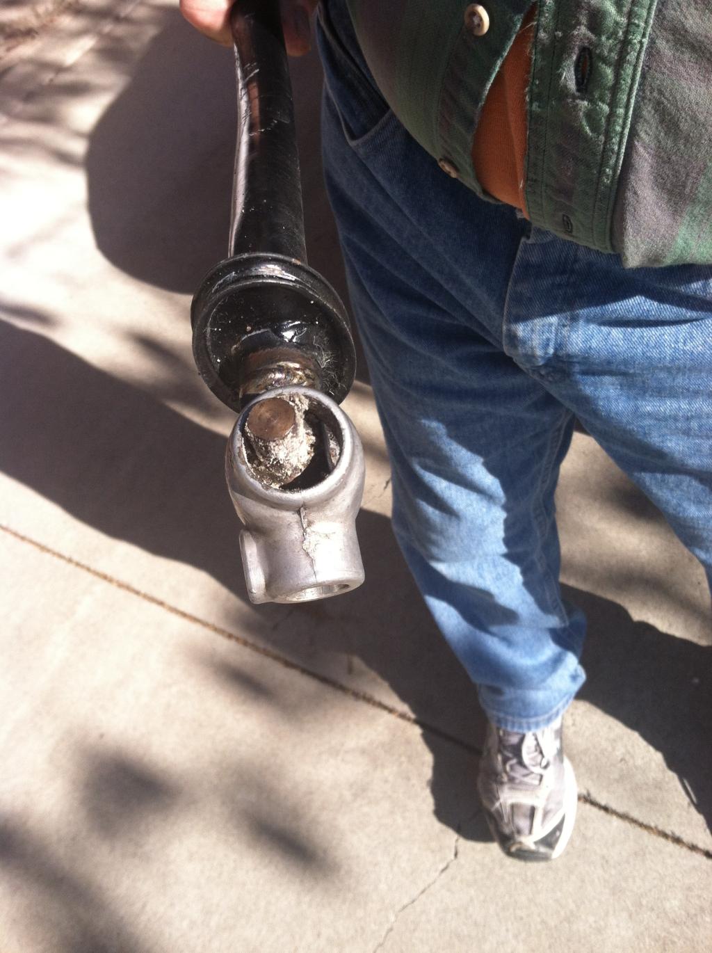

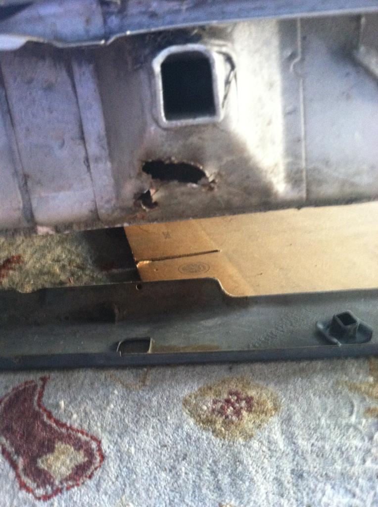

(IMG:http://www.914world.com/bbs2/uploads_offsite/i821.photobucket.com-16526-1427783326.1.jpg) When you patch that jack support, leave a couple of good-sized drainage holes at the bottom corners on each side (IMG:style_emoticons/default/shades.gif) (IMG:http://www.914world.com/bbs2/uploads_offsite/i821.photobucket.com-16526-1427783446.6.jpg) If you can find a set of bronze bushings, you'll probably never have to perform this task again. |
