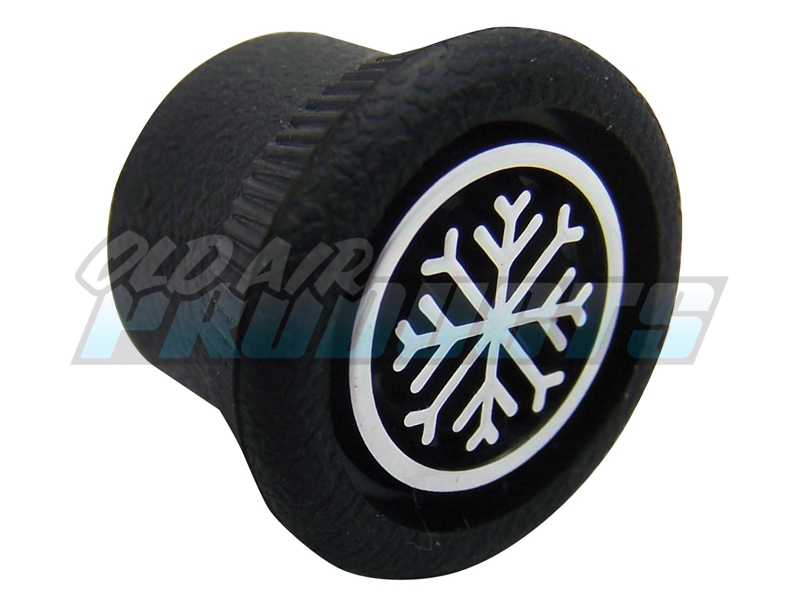

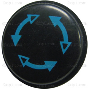

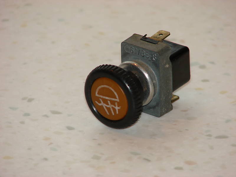

Hella fog light switch question. Are the new 'generic' ones the same as the originals as so the lighted knob and odd nut work?
Also, I have seen but can't find again, an insert, I recall from the vw bus, that is blue and had an air related symbol in white. If not then someone want to make a blue insert with a snowflake?
I think this is what I saw but in blue so it would light up.
(IMG:http://www.914world.com/bbs2/uploads_offsite/www2.cip1.com-431-1428201292.1.jpg)
Stock fog switch that I think would be ideal as the a/c switch.
(IMG:http://www.914world.com/bbs2/uploads_offsite/i272.photobucket.com-431-1428201292.2.jpg)
Or if you're not picky the generic knob probably fits. Fairly sure this one doesn't light up.
(IMG:http://www.914world.com/bbs2/uploads_offsite/www.oldairproducts.com-431-1428201292.3.jpg)
Other options???
