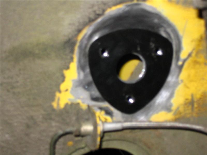

rhodyguy   nifty backing plates. al made these. k   Apr 2 2005, 07:44 PM

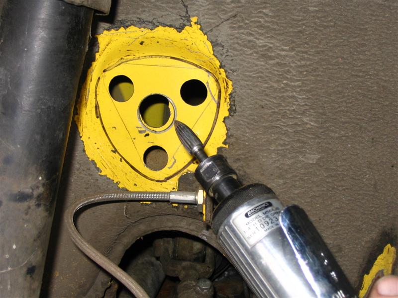

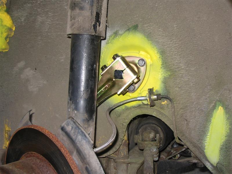

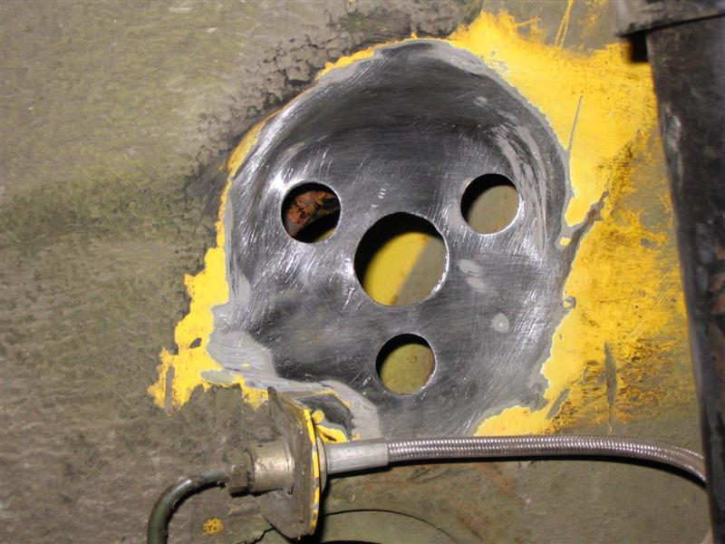

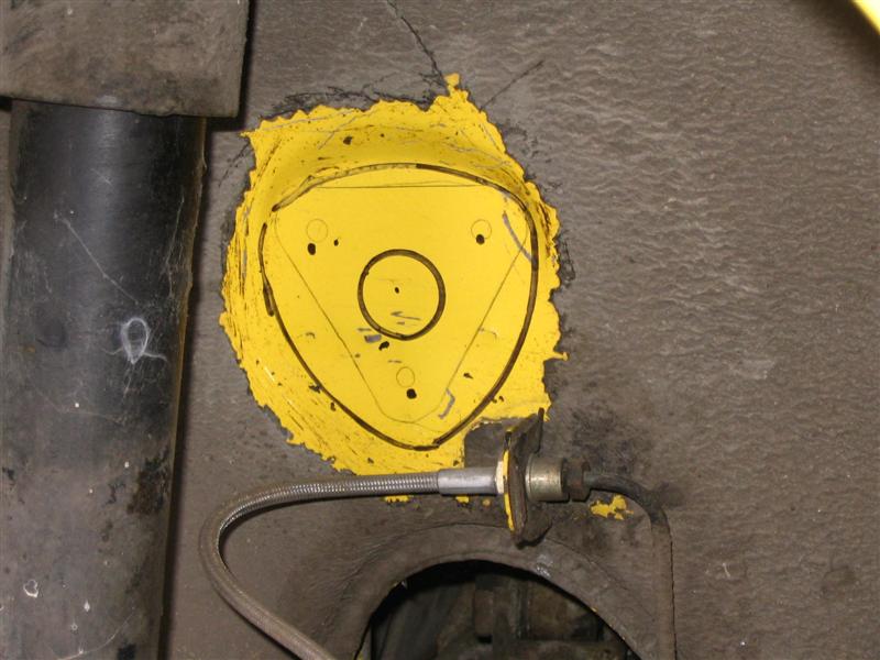

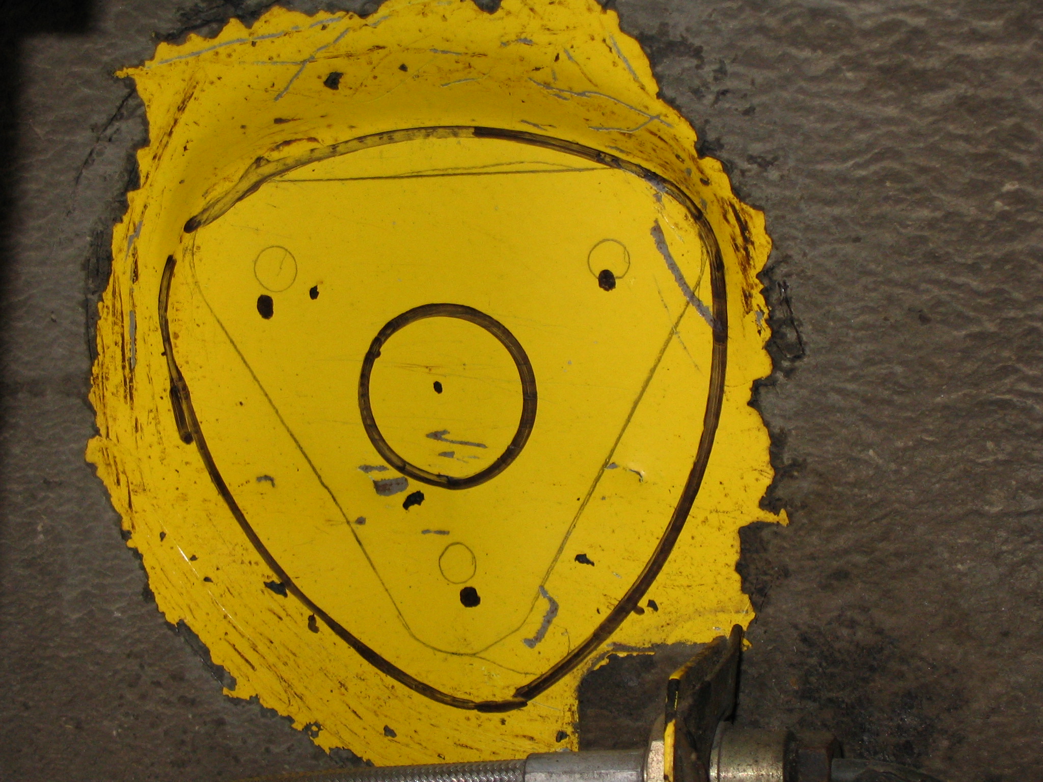

rhodyguy   all i wanted to show were the cuts required to get...   Apr 18 2015, 10:39 AM
rdauenhauer   Those back plates arent required (for a street dri...   Apr 19 2015, 09:45 AM
rhodyguy   Another way to do the front bar.   Oct 23 2016, 02:12 PM
